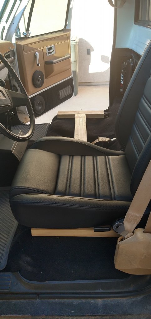

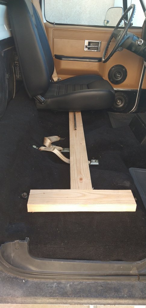

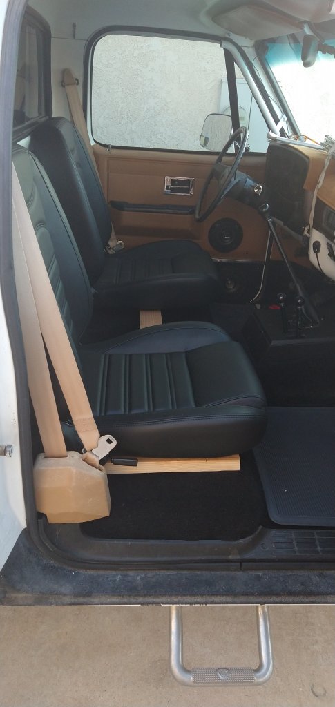

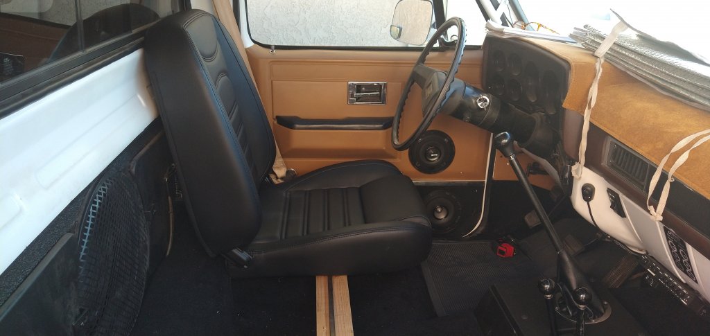

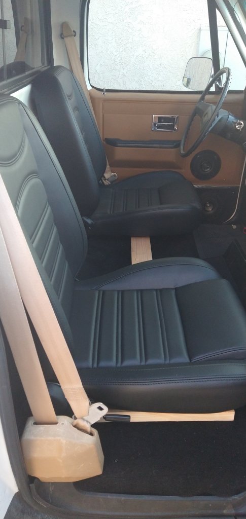

Update: I got the seats "mocked up" in the proper position. Now I have to transfer the measurements from my 2x4 jig to a metal bracket. I'm loving the room I have to create a custom console. I'm thinking cup holders, secret compartment for the 45, and other nefarious intentions. I'm going to have to do something about those hideous seatbelts now. Domino effect, it never ends!

Gonna look great!! You mentioned seat belts. What are you thinking of doing?

They need to be charcoal or black. The aftermarket ones are inferior to the OEM. They lack the plastic cover for the retractable mechanism. I have already cleaned the belts with soapy water and a scrub brush. I'm hesitant to dye the belts. I'm afraid of them bleeding dye and getting into clothing. Disassembly of the belts requires sewing them back together that requires a DOT certification. Maybe I'm overthinking it?

No, I think you’re exactly right which is why I asked the question. Dying is not real doable in this situation and aftermarket belts are subpar at best so that’s why I asked the question. Could always search for an appropriately colored OEM belt set. May get lucky on eBay:shrug:

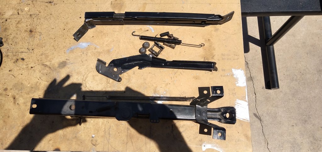

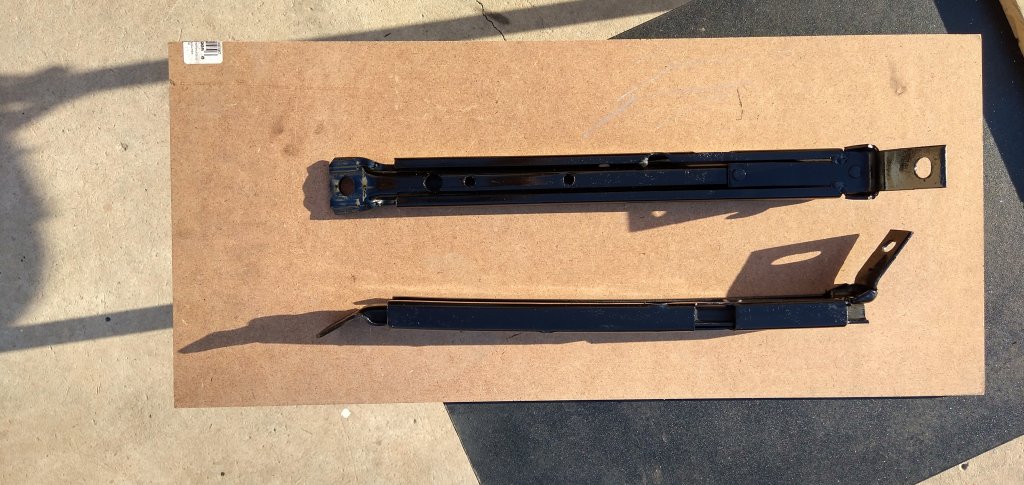

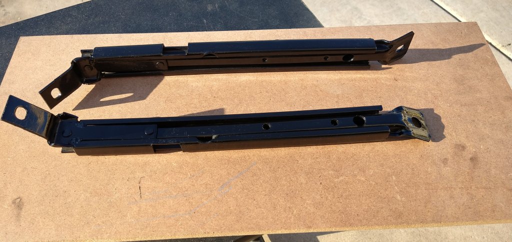

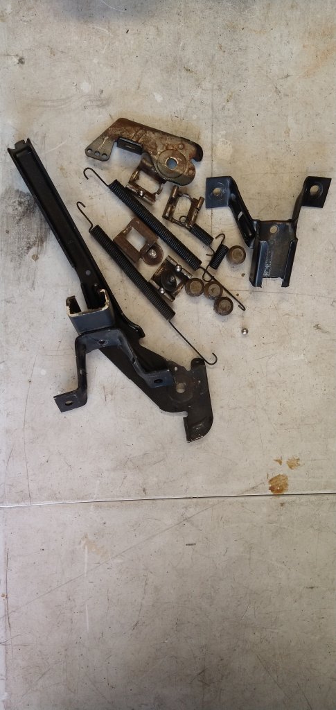

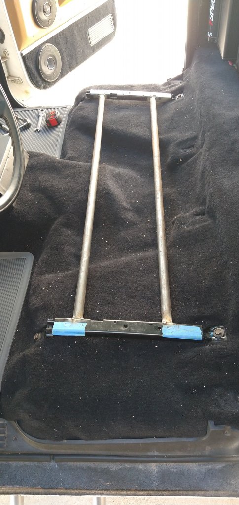

Gutted and welded the OEM bench seat brackets. They serve the foundation for the "rack" that the buckets will bolt to. I did NOT want to drill holes in the floor! Just so happens, there is 1 inch clearance between the bottom of the OEM brackets and the floor, perfect for 1 inch horizontal cross bars. Even more amazing, the floor contour is flat and horizontal across the trans tunnel so the horizontal brace lays perfectly flat and supported without the need for vertical supports. More to come...

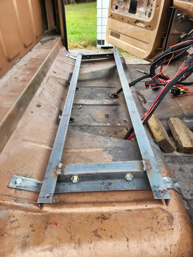

I built this an put universal sliders on top so the seats were independently adjustable, not that anyone ever moves them lol.
Same concept I'm doing except using the stock sliding brackets as a mounting point. What seats have you got?

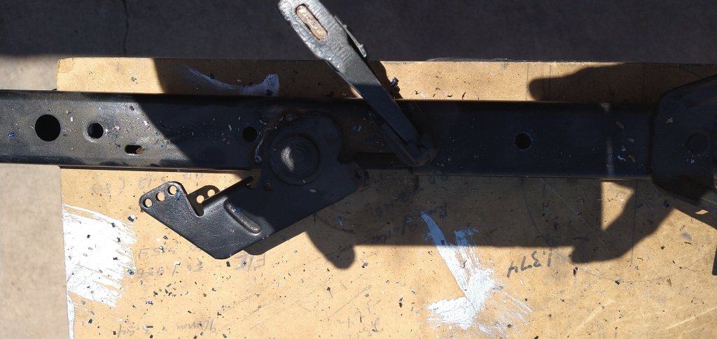

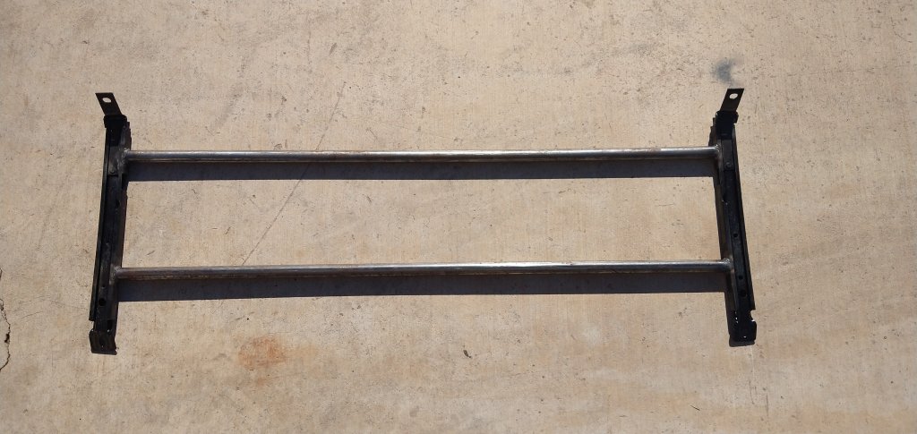

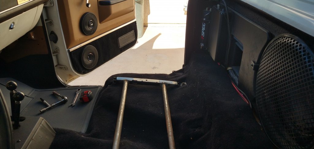

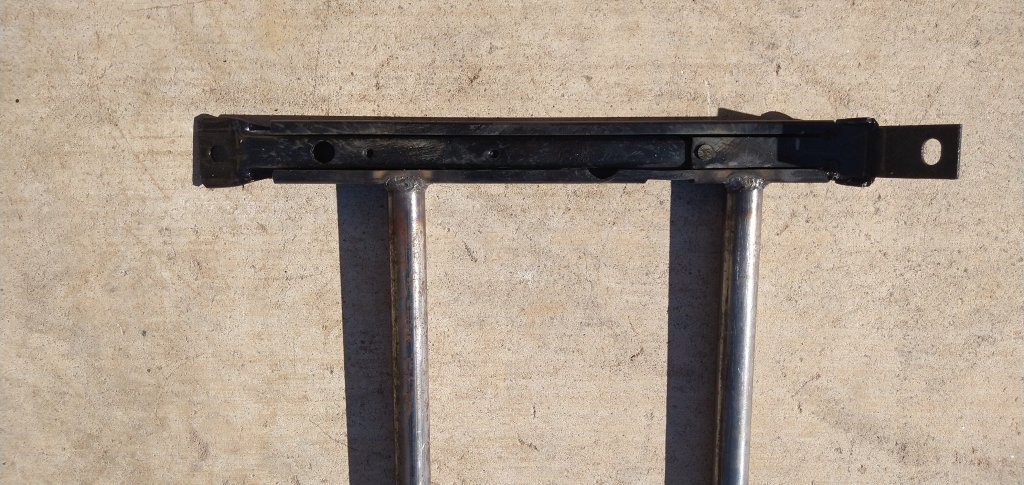

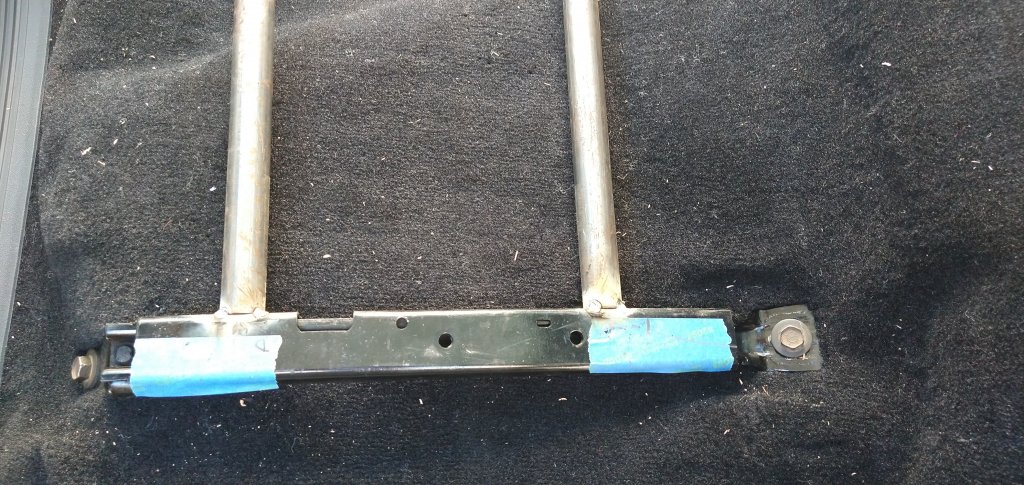

Update: Found an hour to work on this today. I used some existing 1" round, .095 tubing to make the two crossbraces. Since the OEM bench mounting brackets will bear the weight this is plenty strong. I mounted the brackets, squared up the tubing and tack welded them in place. Removed and welded them up. I think these are going to turn out great. Strong, simple and easy to install & remove. More to come.
