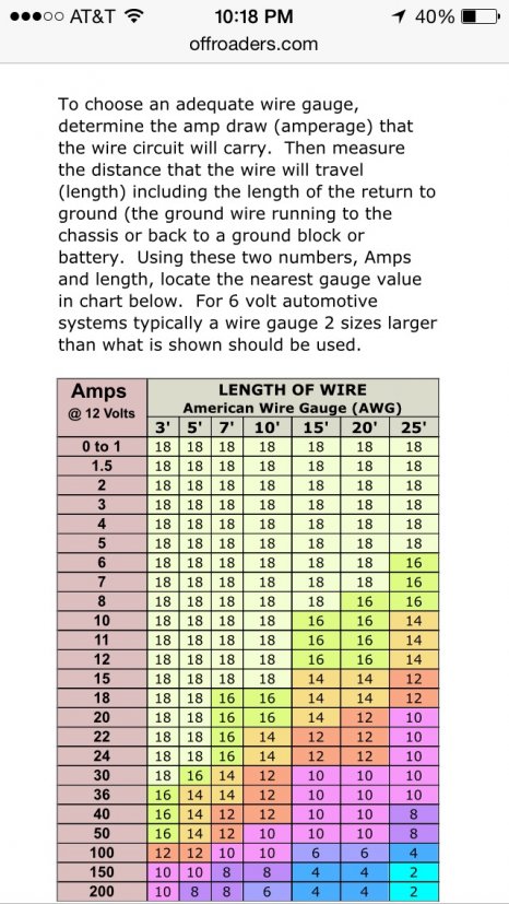

What is the amp draw rating of the light bar?

If you have the proper size wire and seem to be pulling too much amperage be sure all your connections and grounds are good. A poor connection creates resistance that could increase the amp draw. Also be sure the wire is a true guage. Somtimes cheap wire is not acually the advertised guage.
