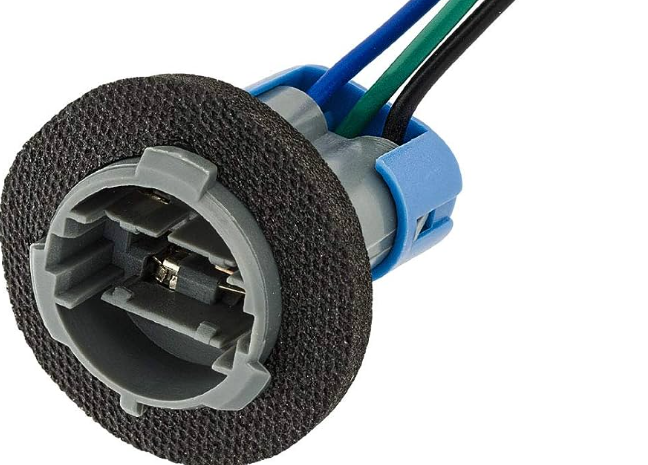

I hate those damn OEM sockets! When I went thru my electrical system I changed every single plug in the harness to weather pack terminals. During that process I also Shtcanned the 1156/1157 sockets and replaced them with modern 3056/57 spade type sockets. No more electrical gremlins for this Chicken Farmer!
