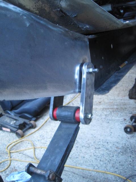

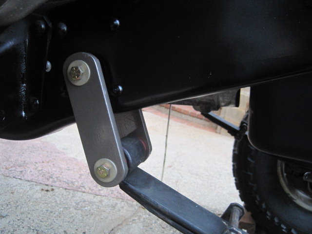

If you're handy with a little fab work then build a set of 1" longer front shackles... Here are a few pictures of mine... Built from 1/2"X2" flat stock steel... Cost around $20 for the steel... By adding a slight lift to your shackles you will slightly increase your caster angle which will give you a little more stability on the road... Good luck!
