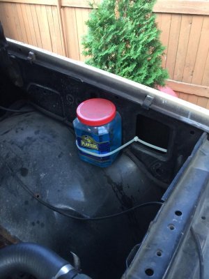

Never thought of the check valve thing! That would work nicely. Here is whats in the wood hauler for a washer tank. I had to leave the label on :party36:
