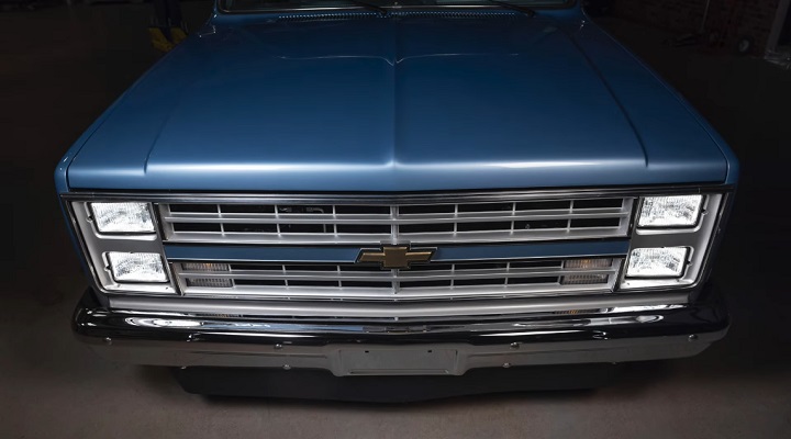

I have a 1987 gmc four head light the light the photo attached. Headlights are 4 x 6.
Has anyone used the holly retrobright headlights?
Holley Shows Off Its RetroBright LED Headlights On Chevy C10 Pickup: Video
When I look at their website
It's not real obvious to me if it's hi-beam or low-beam.
Any other head light recommendations would be appreciated.
The one you have listed is low beam here is the link for high beam
