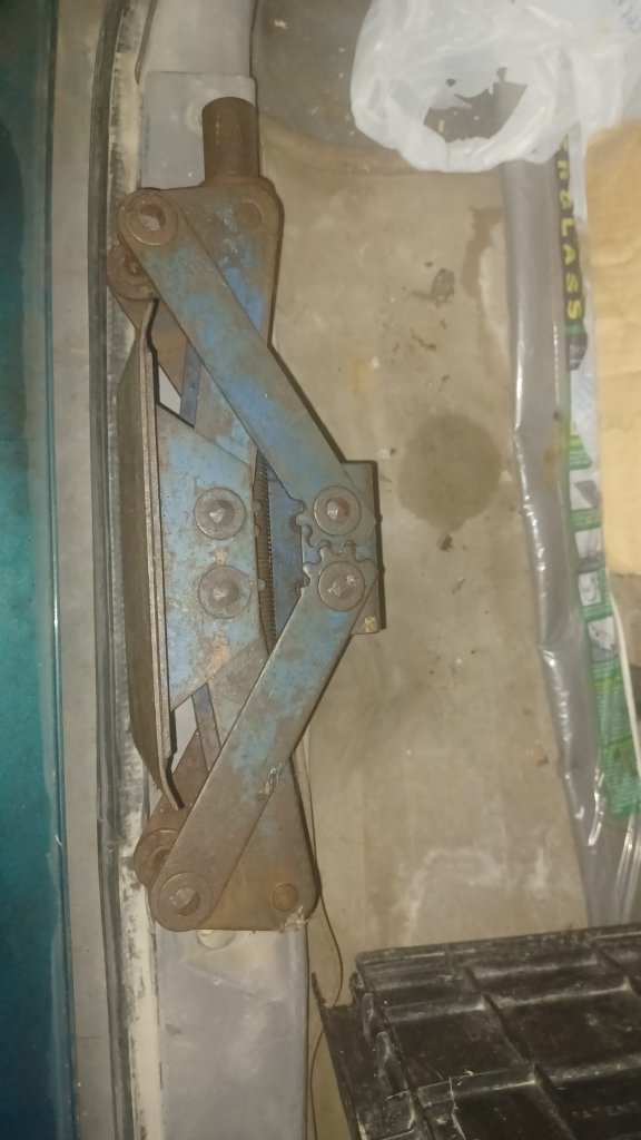

My factory jack for my suburban lifts my 33s no problem and has a couple of inches of room left. Any mounts nicely in its factory spot. Now if I could find my tire iron I'd be good to go.

A good scissor jack with a long crank handle not one of those stamped sheet metal ones

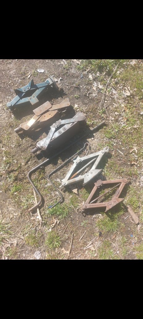

Some of my scissor jacks and what I like about them. All of them have more height extension than bottle jacks.The tops have a good size contact patch and the bases are stable if you set them on concrete or a piece of wood. The top one is a stock mazda b2200 jack,they are sturdy not as sturdy as the next 2,but sturdy and the crank handle us heavy and 3 feet long. The next 2 are Napa,they are heavy duty and have long crank handles. Nest 2 are cheap scissor jacks that I wouldn't trust for anything except a flat tire on compact if nothing else was available.
