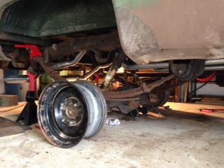

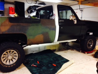

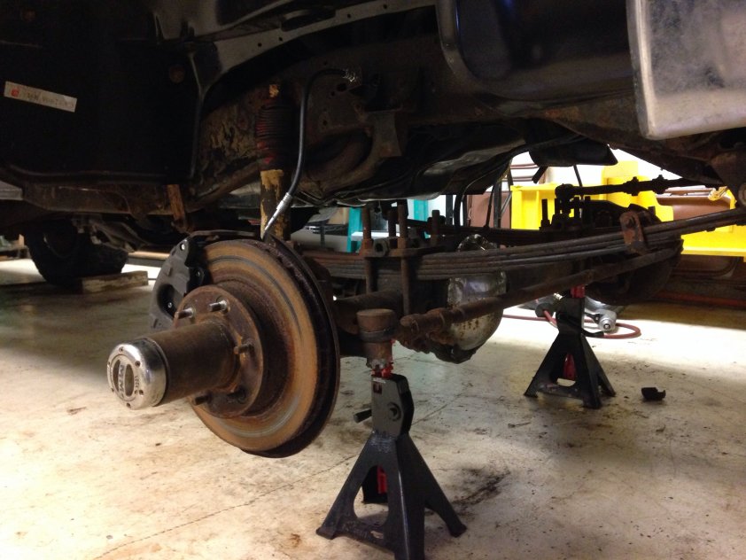

Well, here goes nothing. I got the axles. Rear is installed. Much more work that I anticipated!!! I gotta bring the truck to my dads to use the acetylene torch for the front. I haven't started working on the compressor yet, I also want to hook up a small 5 gallon reserve tank.

Those Wagoneer mags look good on the truck.
Forgottenknight
Nov 12, 2013
13
Andover, MN
Adam
Thanks bucket! Anyone have an idea what kind of rim they are? I couldn't find a name on the back.
Also, just an update.... I got the axles in, took 'er for a spin, and nothing fell off!
