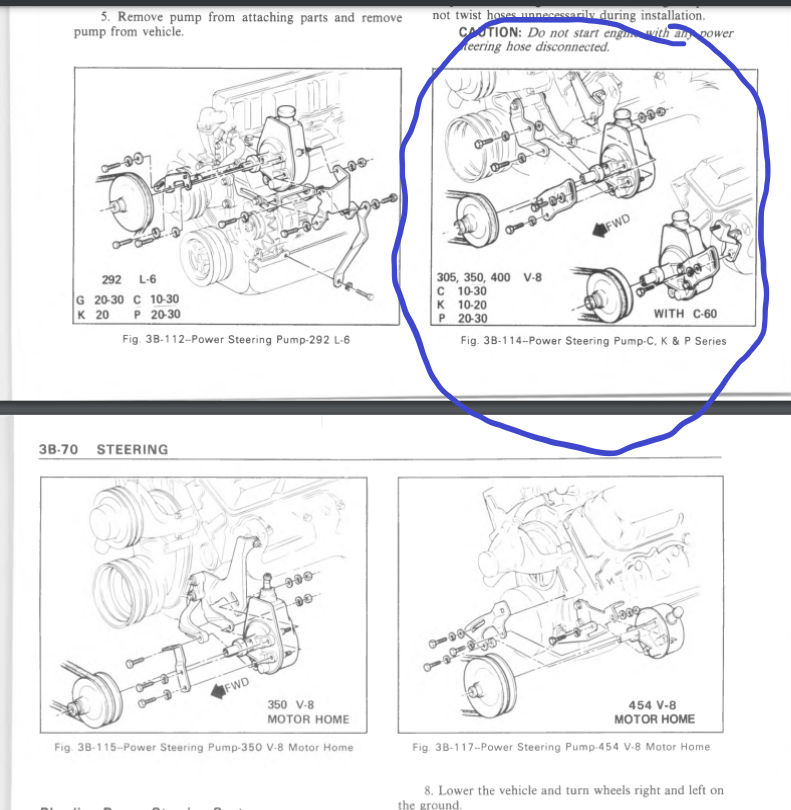

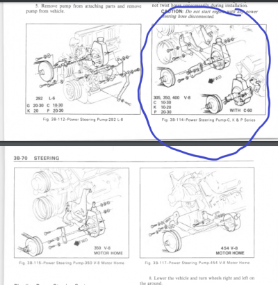

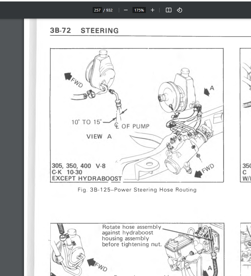

My 1978 3/4 ton 4X4 Camper Special chassis needs a power steering pump and I've ordered two... both not what I have on the truck. One of the new pumps has a return line configured so that it is pointed at the vibration damper, requiring a very tight 180 degree turn in the line, and the other new pump has the pump clocked differently in relation to the reservoir and ultimately the mount. At this point I'm wondering if the bracket is correct. It just doesn't seem to fit correctly. If you have any photos of your brackets/mounts I'd like to see them.
See photos...
See photos...
