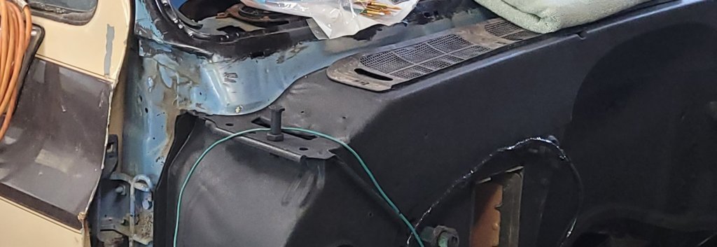

I used the stops off the 78. Worked on the newer cab. The 78 hinges bolt on the fenders. I just removed the ones off the cab that were for the 81-87. The stop you can see in the picture is off the 78 and fit in to thr factory hole. You will also need the older wiper post assembly they are shorter.
