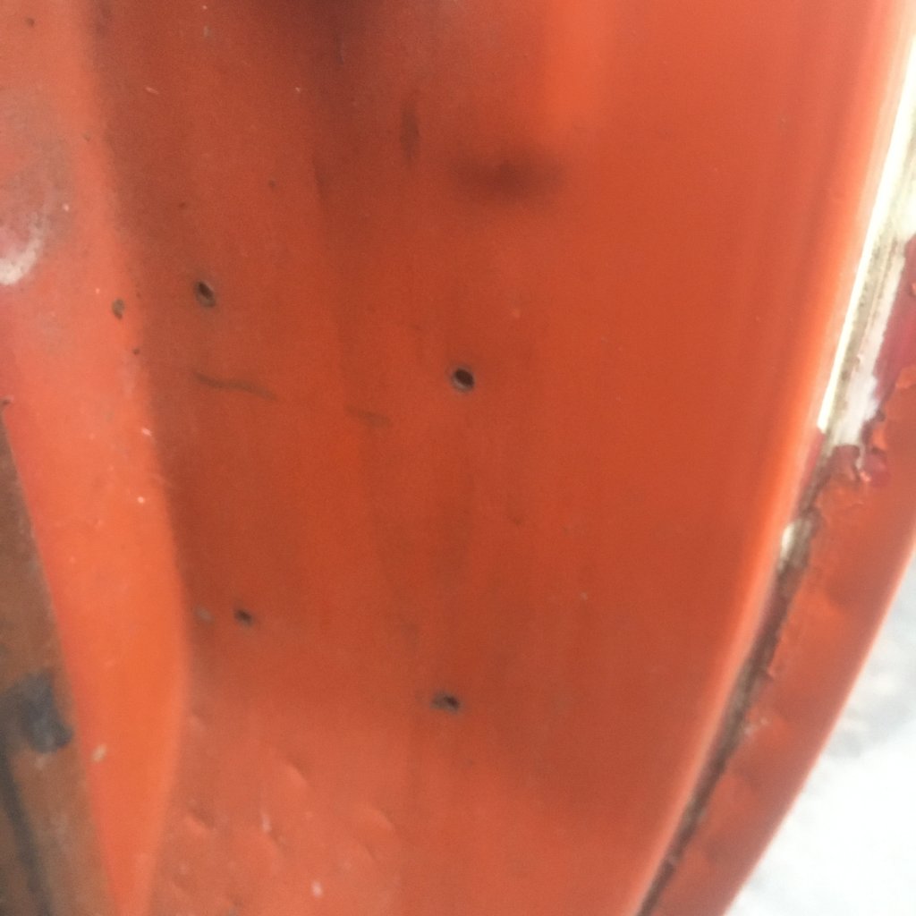

the oddity about this truck is the vin tag on the B pillar is removed, and still has the holes where it was, and it's still titled and registered as a 74. all along with a 84 vin tag in the dash window.

If it was just a part he got from somewhere, the PO likely didn't have the title for the whole '84 truck. It sounds like it was only the dash, not the whole cab that got swapped. The real concern is how the VIN tag in the B pillar disappeared. It's generally a felony to tamper with them. Sometimes people will remove for paint and then directly re-install, but that is still technically illegal(although intent is a big one there). It's also possible that only the frame is original and the cab is from one vehicle, dash is from another, and frame is still the original that you have the title for. Or it's possible that not a single part on that truck is from the original one that you have the title for. You just don't know until you see the correct stamped numbers somewhere.

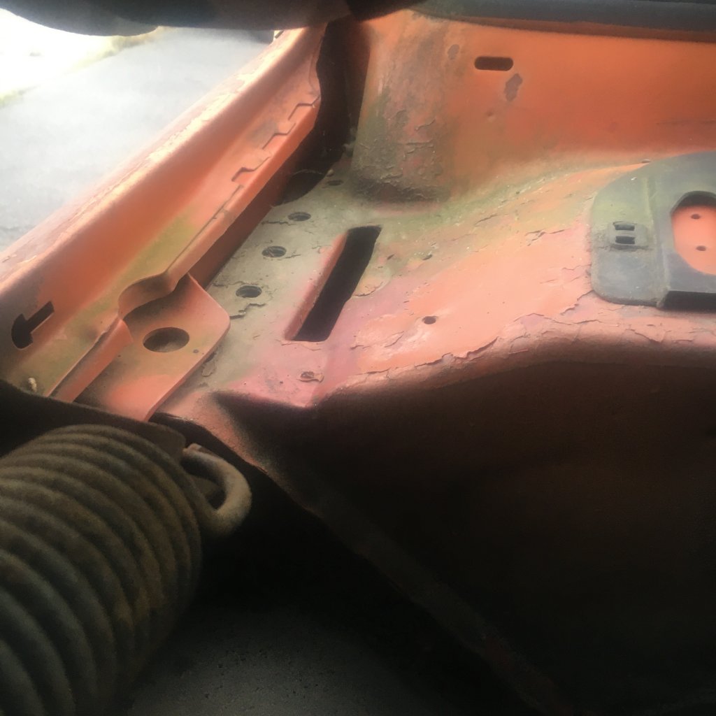

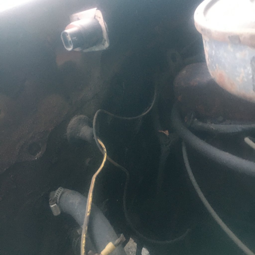

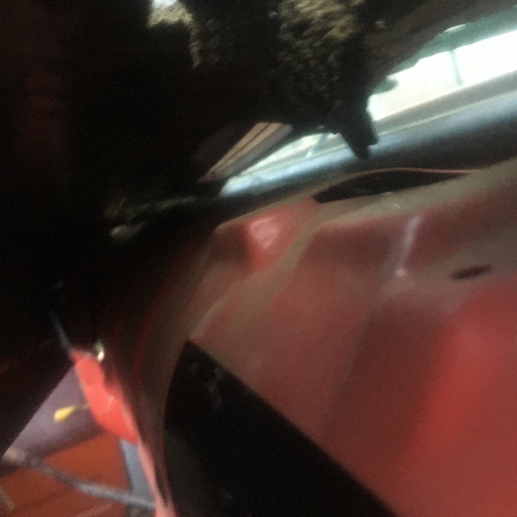

Well I never hooked up with the owner so when back and looked at this thing again.
It sure looks like a 84 cab. couldn't find a vin on the frame rails, which didn't surprise me and never thought to bring something to scrape off the flat on the block to check numbers.
I left him a message that if he had the vin tag for the 74 I'd try to make a deal with him and without it it would only be worth parts value and probably less then a grand.
couple things I noticed on the cab that aren't 74 is the hood hinge pockets, the vac switch on the firewall and what I could manage to see under the dash pad corner that I was able to left up a little looks post 80.

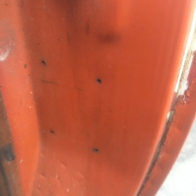

this is what confused me when I first saw it.

That's what I was saying in a earlier post was about the frame and engine block numbers and where to look. Man, this thing is sounding schetchy more and more. But, @Bextreme04 is right. Louisiana is like that to but I believe all those number have to be there. If any are missing you have to have signed papers of why they are not or what was done then that has to be documented. You need a ton of paper on this thing so when you go to get a title they will be asking for it all. If you don't have it... I wouldn't give that guy a dime until he has paper, paper, paper.
