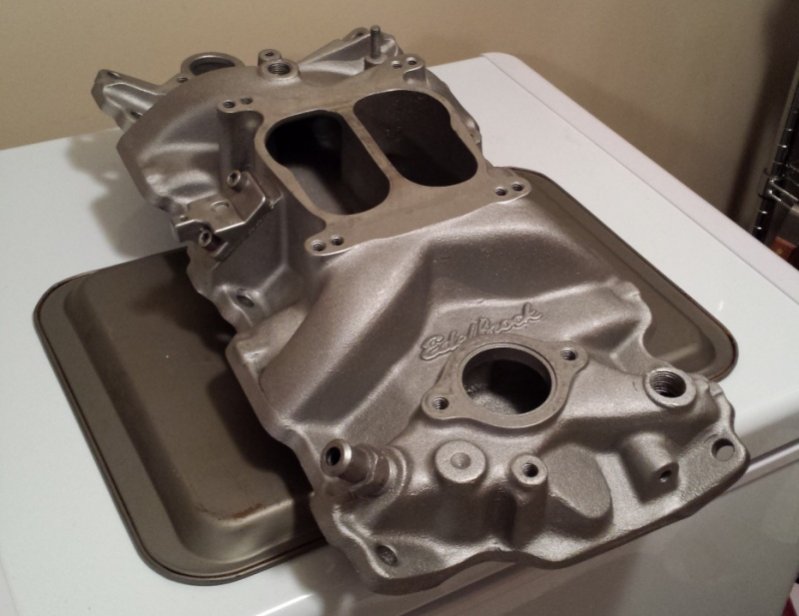

Ya I hate the fact that the bolt kits from the hot rod shop seem like they are a 1/4 inch to short. No room for lock washers. Im sure you could get those in 1/4 inch increments
Swims350
4,357
818
Logan WV
none
I actually bought a set of small head stainless intake bolts from summit they have a 9/16 flange under them but the head size for a wrench or socket is 3/8

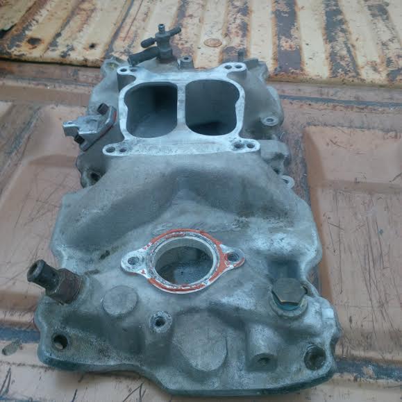

Here it is before cleanup... From my understanding this is a older generation of the performer.

Looks the same as mine. Should work just fine. You should try brake clean even on just a corner to see if it will shine it up.

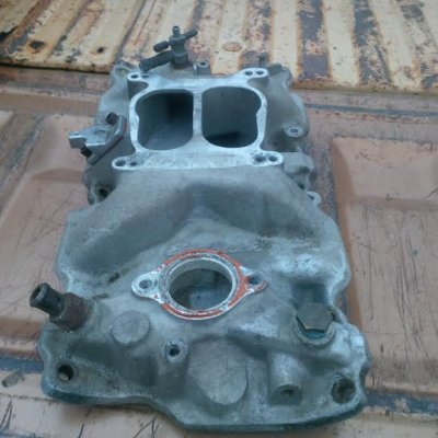

Same intake gone over with a aluminum wire brush and then painted with my appliance enamel paint.
