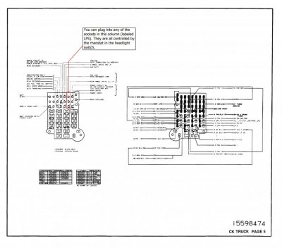

Where do you intend to mount the tach? That might make it easier to help you find a convenient place to splice into the dimmed lighting circuit.
But it isn't that hard anyway. There are only 3 branches to that variable lighting circuit:
1. The illumination for the instrument panel
2. The radio back lighting
3. There is one bulb on the right hand end of the HVAC control panel
The last one - the heater control panel is probably the easiest to get to. But they all are on a common wire - the gray one that Retro mentioned.
But really, the easiest thing to do is just run the tachometer backlighting lead over to the fuse block (again, as Retro suggests) and plug into one of the sockets in the 2nd full column from the right. The column is labeled LPS:
