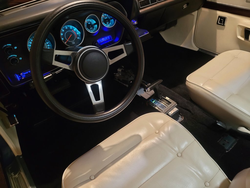

I know what you mean, I tried the first generation of LED bulbs on my old motor home and hated them. I waited at least until 3rd gen LED were released to try them again. The turn signal issue you mentioned was handled years ago, everyone makes LED compatible flashers, even Sylvania, so no need for resistors. It's all plug and play now, they have upgraded from plug and pray. The dimming issue is no longer a valid concern, that has been corrected too. (they sell both dimable and non)I used them in my gauge cluster on the Charger and they look amazing, and they dim.
There is no longer a skill set required to install LED bulbs. The old yellow light bulbs influence how your eyes percieve color, they taint the image. White light (sun light) gives you a truer view of the actual colors of your interior, or whatever they are illuminating. I have had older people tell me they don't like the whiter spectrum of LED lights because it reminds them of hospital lighting. Kinda funny considering most hospitals use whiter (daylight type) bulbs to simulate sun light to make it less depressing to be there for extended periods of time.
If you are really into the vintage look of interior lighting, they also sell other types of white from 2700k up to 5000k. You can still have the look you prefer and have the advantages of longer lasting, lower power usage LED lights. 2700k is towards the yellow side and the closer to 5000k the whiter the light, when you go higher than 6000k they start to have a slight blue tint.

I'm not trying to be a jerk in saying this but the one thing that I'd hoped when I made the thread is that it wouldn't turn into thread about LED bulbs but here we are.
The turn signal issue, yes I know the original drop in LED bulbs did not play well with flasher units that's not what I'm talking about. What I think I'm seeing is the drop in LED bulbs shorting internally, there by causing cross bleeding of the circuit, for example a guy might turn on the right turn signal and all the marker lights flash because one of the drop in LED bulbs is bleeding voltage into the running light circuit. This does NOT pertain to just the older generations of LED's, we see a few rigs a year at the shop with this issue. I have never paid attention to brand names, of the LEDs causing this, as I said I don't know where the customers are getting them from.
I agree the older LEDs we worse as far as the spectrum of light color produced, but you missing what I'm saying. In a modern vehicle equipped factory with LED lighting it looks fine. The drop in bulbs in an old dash meant to be lite with 2,700K incandescent bulbs, looks bad IMO with modern drop in bulbs. Just my opinion you don't have to agree.
I have seen enough drop in LED installations at the shop, to know that it's not for me. Would I put one in my dome light to increase the amount light output, sure if I find I really need it, but that's as far as I'm going to go. Maybe a few more generations of LED refinement and I'll feel differently.
