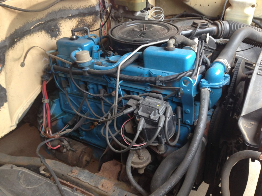

If you don't have to meet 1986 emissions specs, try to find a 250 without the "integrated" cylinder head & manifold. They are prone to cracking. Also skip the engines with two chambers, valves, and hoses on top of the valve covers.
I agree that a 292 would be perfect and probably makes 25% more torque than a 250. Also, if your truck's axle ratio is numerically lower than 3.08, a 250 will not be very happy. Not sure about 86 models, but in 82 the standard axle for a 350 with auto trans was 2.52.
On another note, I went the opposite direction on my 82 -- from 250 to 350. As I recall you will need to drop the motor mount brackets to the lower set of holes on the frame. And of course you will need different mounts on the engine. Other things that I remember being different are fuel line length, fan shroud, and of course engine wiring. However, you won't need to touch the transmission crossmember or change driveshaft length or shift linkage, if you stick to a TH350.
Attached are pictures of my 1982 250-six. These may help you with wiring and motor mount brackets.
