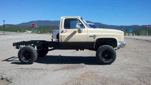

Anyway, I was wondering how much of a mission it would be to install independent front and rear suspension on one of our squares, if at all worth it. Namely an '82 K-10, no bed if that matters.
I need to replace the axles anyway, so would this kind of thing be feasible without sponsorship? I had seen an S-10 with modified Corvette Dana 60s I believe (don't take my word for it though), front and rear.
I want to be able to handle well at speed on a dirt road, while still being strong getting to those remote locations.

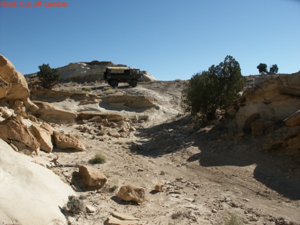

The roads are a mix of sand, gravel, and sandstone, and have a lot more aggressive bumps than washboard. If anyone has ever raced through Northern NM washouts, you'll know what I mean. It gets rough, with a lot of turns inside valleys and canyons. The picture below shows a bit, but there's a lot more to it.

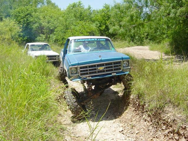

Who needs IFS??? Go Straight or Go Gay !!!!
