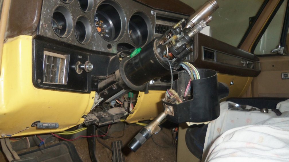

Here's where I'm at. Can't get those fuggin Pivot Pins out. Not sure wth they're made of, but even brand new titanium bits won't even cut it. Worked the bit real slow to hope it would grab and cut but no dice.

You are probably going to need carbide bits. Are you attempting to drill the pins or the broken tool part left in there

So more drilling, breaking off taps and ********. Both plugs with bolts or taps broke off inside, said, F This, there has to be another way !!! Started looking through the bottom. Long story short. Got a long punch, had just enough, I mean just enough room to get a good solid angle hit on the left side plug and got it by pounding it out through the bottom of the column. Right side plug, no dice. Then after further thinking outside the box. I realized if I turn the front wheels and move the knuckle where the 2 shafts join, I'd gain an 1/8 inch. So I jacked up the front wheels, turned them to get the knuckle to move. BAMM !!! Knocked that one out too from the bottom.

Sooooooooo, Now I've got it all back together up the part where I'm putting the spring, cancelling cam/horn plastic and lock plate on. It won't seat deep enough to get the snap ring on. I found that the piece that goes into the bearing race isn't cooperating and I can't seem to get it in where it goes taking up valuable space. I sure don't want to pull it back apart. Turn signlas, wipers, ignition cylinder, rack, sector, hi beams, all that **** is working great. Ignition is now smooth as glass and the guy said it was stiff and had to turn the real deep to get it to start. Not now. He says it feels like brand new. Well ****, it should be, it's all brand new. Replaced the Rack, the Sector and spring, and the ignition even though it was fine. He wanted it replaced too since he only had 1 key and it's wore down.
So what's up with that piece @89Suburban? You know you have the bearing race that you push down in the bearing, that goes fine. I just can't get the other piece to fit inside it now.

I got it finished before noon today. We had a 60 degree day and I went over there early and had it done in an hour or so. It was nice and sunny, so I rolled it outside in the driveway in the sunlight and could then see what was wrong. The old guy had closed the fingers on that spacer thinking they go inside the race. No, it's open them up so they can go around the steering shaft. All together and working just fine now. Finally close that fukn chapter.
