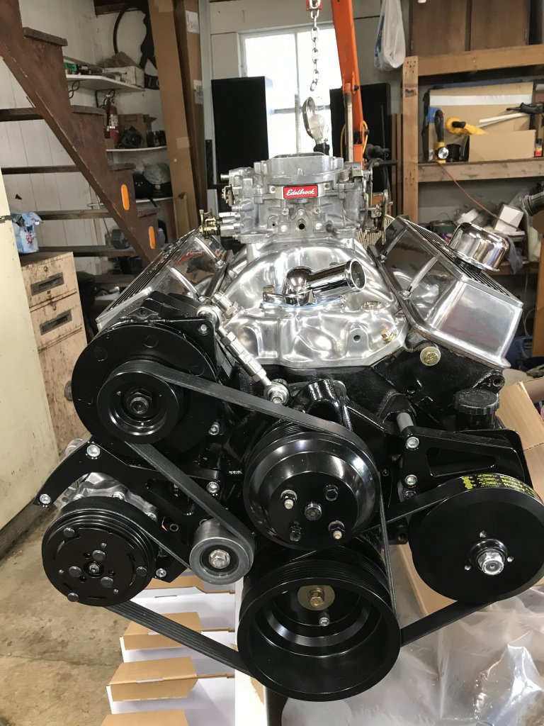

I paid $80 for a unit out of a 88-91 Burb. Another $200-300 for belts, powder coating, alt and PS pump rebuilds. Came with good compressor but not running it right now, so AC delete pulley. Didn't need all that but I wanted it nice.
