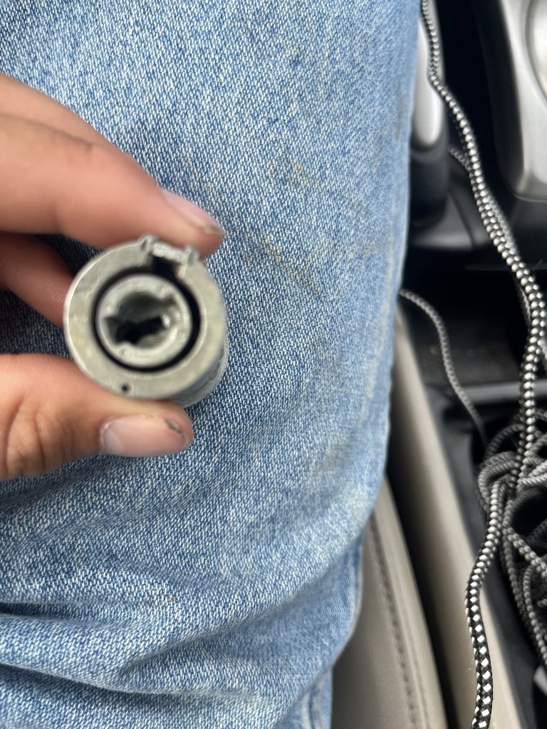

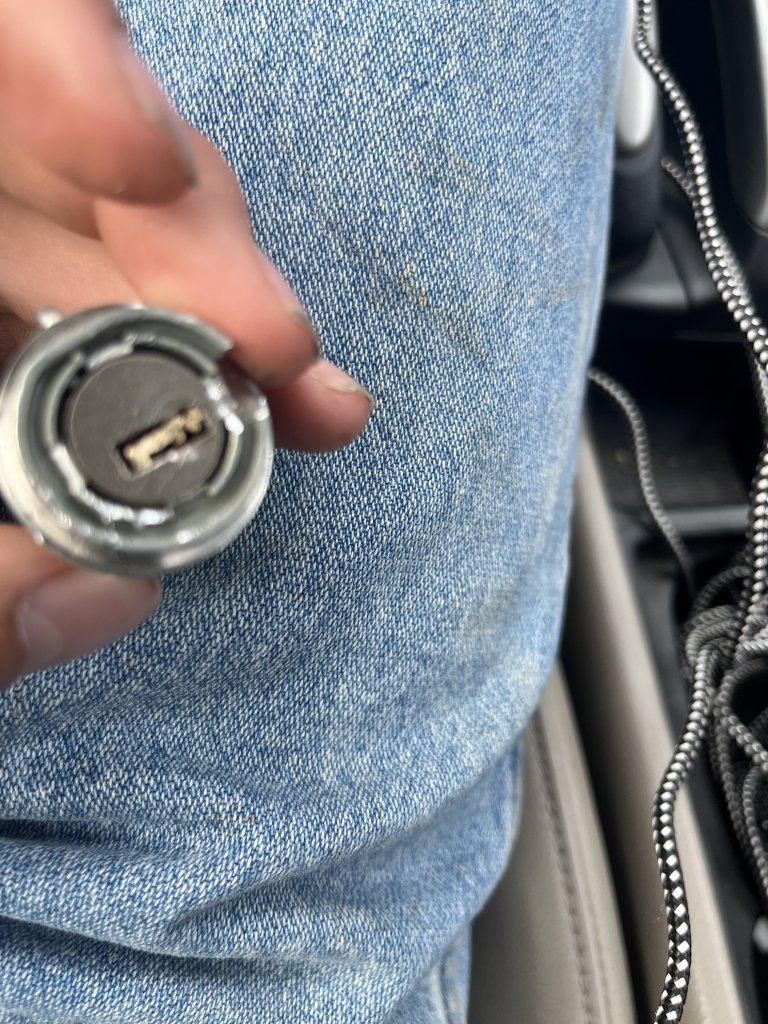

She’s out! The tab that needed to be depressed was bent, not allowing it to push down. Hammered a screw driver on it and it slid right out. Now my new problem, the lock cylinder I got isn’t going in. I think the guy at the counter said it fit a 78. Did they change lock cylinders between 73 and 78?

Good luck Sir, my column didn't look the same but is a little newer than yours.
When the guy said he had to knock out a piece of aluminum with a punch I was expecting it to be one of those guys on youtube that has no clue, but it seemed legit so I shared it.
I had this issue with my 78, there was a piece of cast aluminum that needed to be removed. Behind the pirate was the release tab its paper thin but it looked solid since it blends in with the rest of the casting. Mine did not have a retaining screw.
