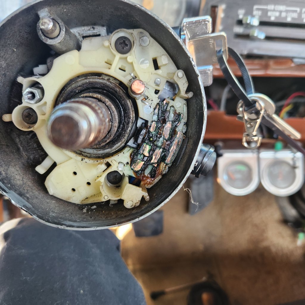

Where the arrow points too is what looks like to be a slot with the flashing still closing it, and it seems to line up with a tab that's on the old ignition cylinder, this slot would have had to have been opened up to depress this button to release the cylinder, the newer cylinder doesn't have that tab in that location, I may have to find an ignition cylinder that matches my old one in order for it to lock into the column?
you appear to have the 1978 design(possibly?)

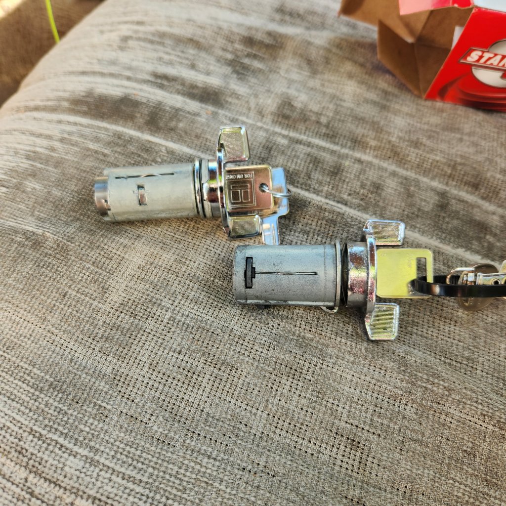

I'm not sure but it might be the 1978 design, look at the lock cylinder on the top it has a notch cut out of it I'm assuming that's where retaining screw goes to hold it in place, but if you look at the box cylinder below it there is a protruding tab type thing that I've circled I believe that should have to be pressed in to release a cylinder, but it remains inward all the time I can't get it to come out. Maybe with the diagram previously sent I can disassemble it and see if I can fix it? Otherwise I need to find one exactly like it.

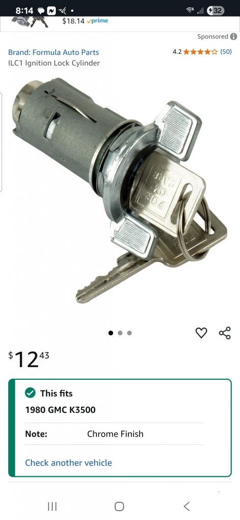

I found this one on Amazon and it refers to fitting the models without the retaining screw, it seems to appear identical so maybe I need to try this one?

The last cylinder I purchased from Amazon has the spring loaded retainer, it snapped and locked right into place!
Thanks for everybody's help! This one my dad's truck he bought in 1980 from the factory and I am trying to repair a few neglects so that it can be comfortably driven. These neglects are just more annoyances from age, not from abuse! I remember when my dad got this truck, it was his baby!
