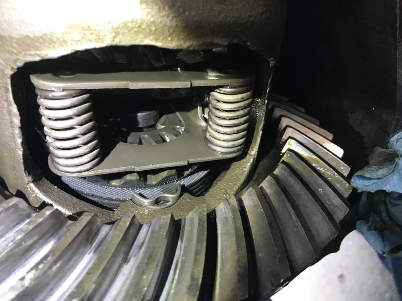

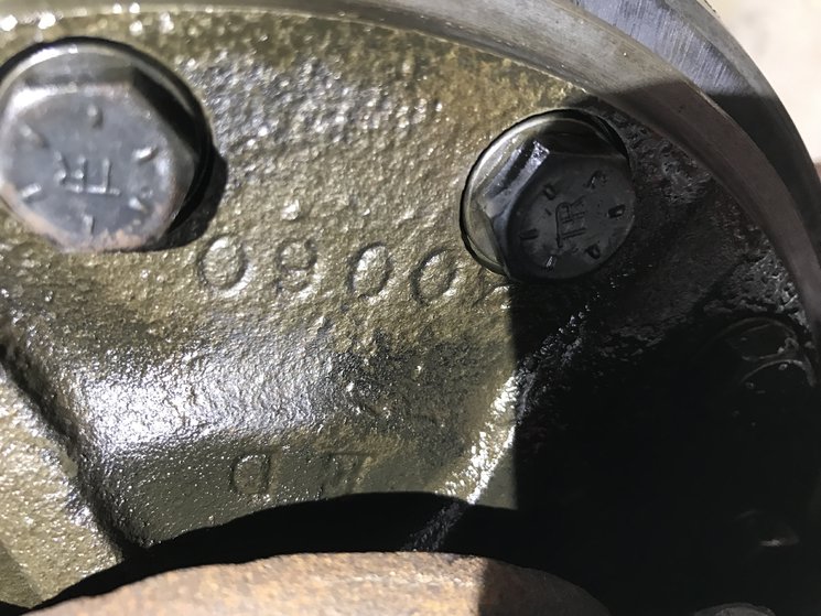

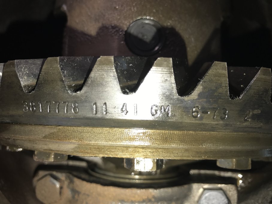

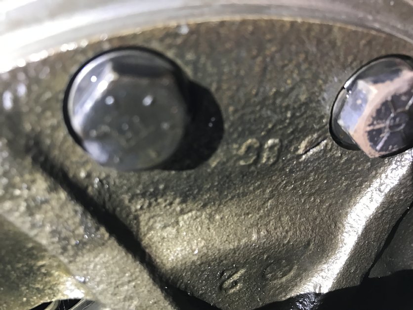

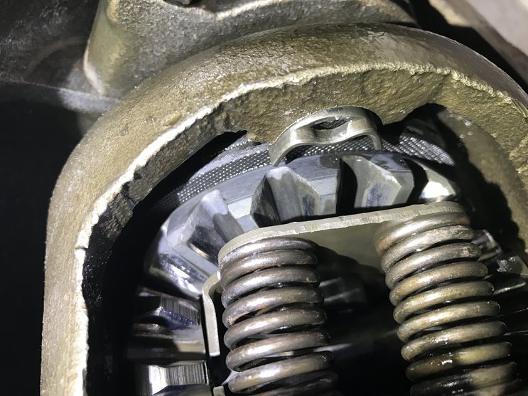

Finally got around to look into my rear end and I need some help identifying my configuration.
Gears appear to be 3.73 but the carrier is somewhat elusive in the searching I've done. It appears to be an Eaton posi but thats the only info I've found that seams to jive.
Any help would be awesome
Thanks in advance!!

you can count the teeth on the ring gear and the other gear, then divide them to get you ratio.

The numbers IFO the "GM" is the gear ratio "11 41" = 3.73. If it said "10-41" that would be 4.10.

It does appear to be a Eaton Limited Slip Unit. Those gears are manufactured June of 1973. Is this a 12 bolt rear axle? An 87 should have a 10 bolt.
29,146
24,099
And the plot thickens! Yeah what rear axle is this? If it's a 10 bolt, the gears and carrier must be from a '73 Camaro or something?
