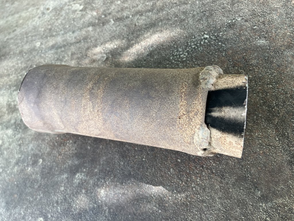

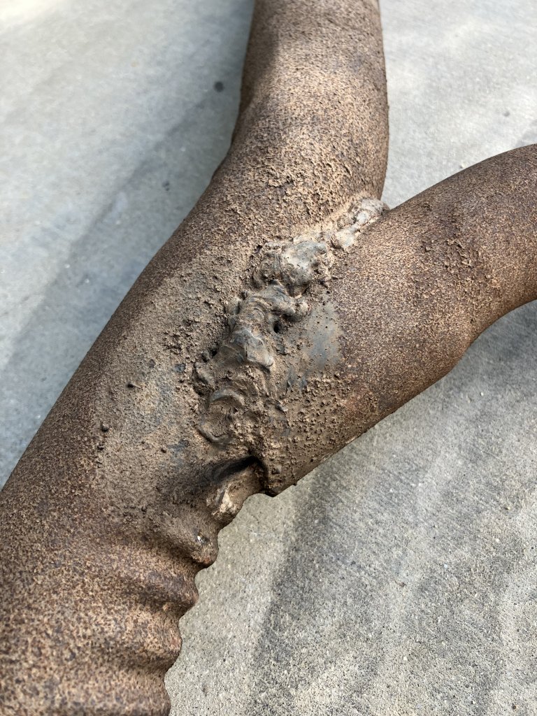

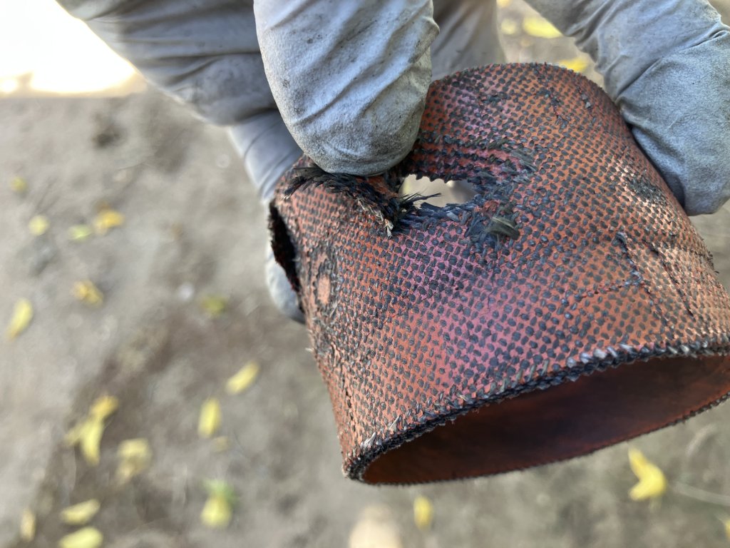

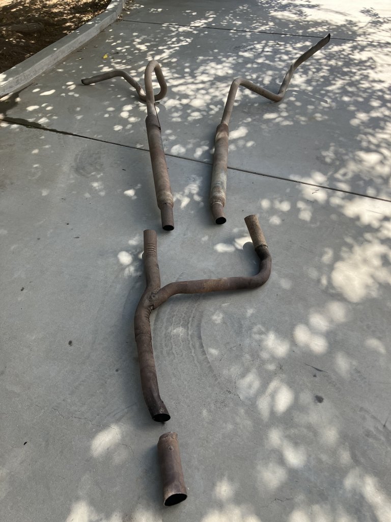

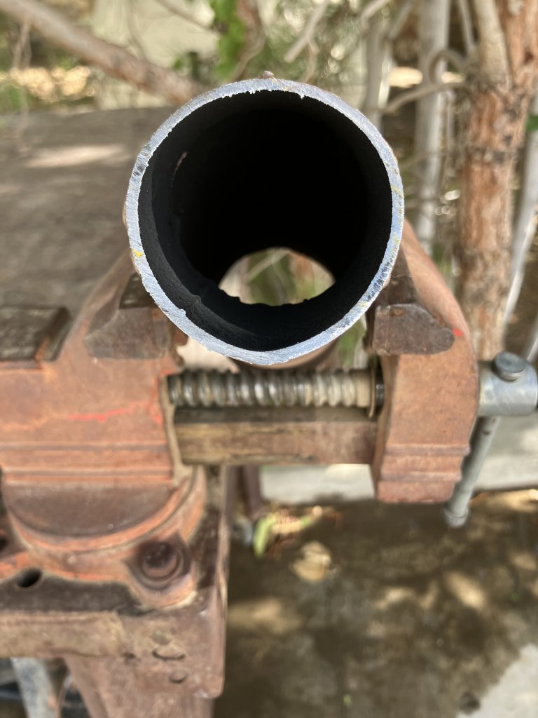

Update: earlier this month I got back to where the truck is stored in SoCal. I first confirmed an exhaust restriction. The 3" hot exit from the turbo was reduced to 2" then split to tie into the original dual exhaust system. The soot trail on the third pic indicates where smaller pipe was inserted inside a larger diameter upstream but the imperfect weld leaked. It was also inserted at an angle, probably to help make the turn from down to back. But excess inserted smaller pipe further restricted flow inside from circular to oval. Sheesh!

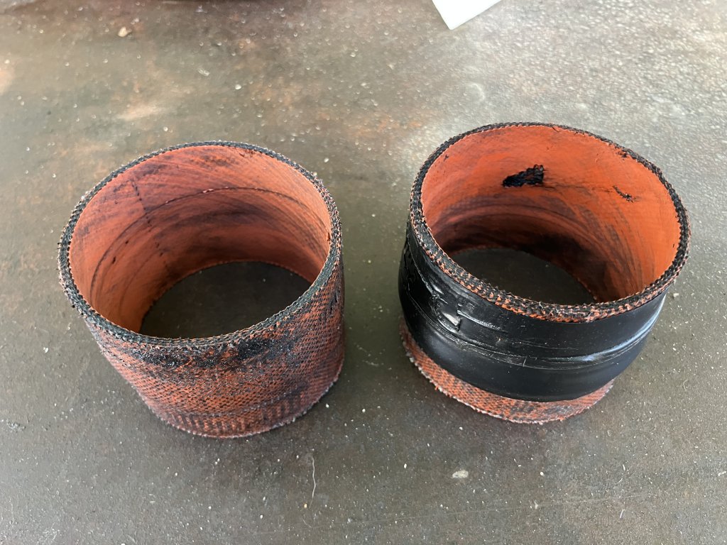

To quantify things I found a port on the intake and plumbed a boost gauge into the cab. There's currently no radio so I jury rigged by stuffing the gauge there. The max boost I saw was about 2 psi at WOT. After cutting out the restriction for open exhaust at the downpipe it woke up noticeably. Boost increased to about 5 psi at WOT. But! Suddenly I could hear the turbo whistling. It still rolled a little coal mashing the pedal at low RPM before any boost pressure. At that point I had an exhaust shop run straight 3" pipe. No muffler. Yet. Maybe later. The muffler shop kid was young but sharp and realized the turbo boost to intake must be leaking air because it spooled up too quickly. That started me chasing leaks. First was a blown out silicone coupler between the steel and aluminum hard plumbing. Electrical tape under the hose clamps was a good clue that some prior buggery was in play. For quick and temporary I cleaned and patched that wound with RTV, splinted with aluminum flashing, and moved that coupler to the suction side from air cleaner to turbo.

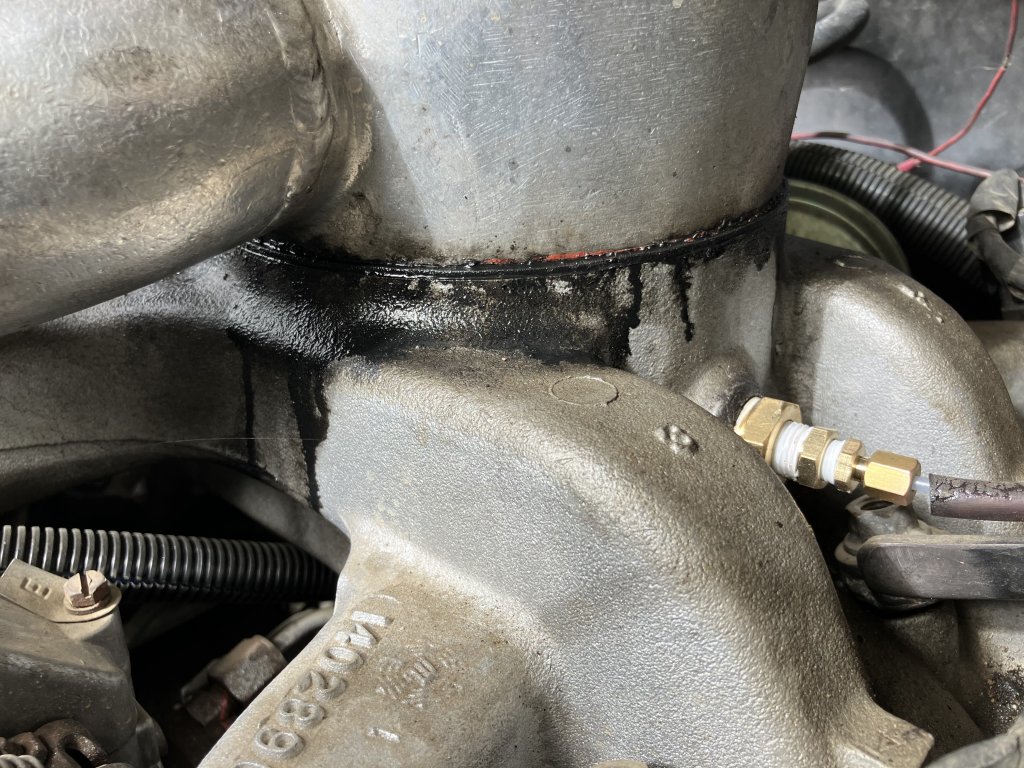

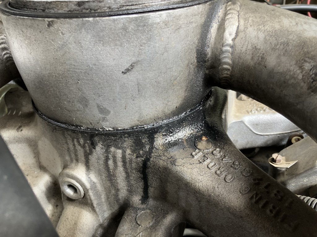

That moved the leak downstream where the in/out diverted plumbing sits between intake manifold and air cleaner. Then I realized that connection was actually a bit loose. Tightening the air cleaner stud nuts was a problem because the nuts were so far down at the bottom of long studs too close to the front/rear edges for a wrench or socket to grab. So I improvised shims to shoulder the nuts up above the rim of that canyon to get a gear wrench on them.

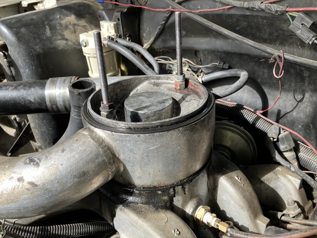

While it sealed that joint the shims themselves leaked. So then I found metric threaded rod and couplers and built studs that shouldered at the bottom while extending hex sides for gear wrenching up above the rim. I also tried sealing the bottoms with rubber washers and RTV. So far so good there. At this point boost was still only 5 psi at WOT but the whistling indicated more air movement and I could tell from behind the wheel it was running a bit better with each iteration. Then I noticed it was pushing apart the boost side coupling. Trying to torque the hose clamps tighter started resulting in snapped hose clamps. So I locally sourced some heavier T bolt clamps and heavier hose. They didn't have proper silicone so for temporary I'm using higher quality Gates reinforced water hose. I don't expect it to last but I only had a few days this trip to get some answers. So now it's running better. There should be more boost pressure. I found a shop that specializes in rebuilding turbos. He and the muffler kid agreed that this simple old turbo seemed healthy since it's not unbalanced and lack of play indicates the journals are not shot. However! At this point I'm thinking there is a lot of blowby oil. Maybe the turbo is internally leaking air. Effectively acting like a waste gate. Which this old style turbo does NOT even have. But I'm out of time this year. Hopefully early next year I can remove the turbo and have the guy go through it. He knows that Roto-Master brand and said he's worked on them before. So I'm optimistic.

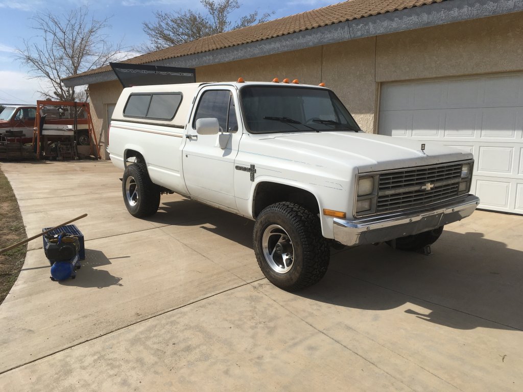

Thanks. It has good bones and potential. My other half even took a fancy to it. Here's a pic from when I got it last year from my buddy's widow. It was stolen and recovered in the mid 90s minus bed and messed up dash and interior. After getting partway through putting it back together he got disgusted and moved on to other projects. So it sat garaged but neglected until I came along last year. This pic is with the wrong bed (mid 90s) and nice but wrong wheels. They're too big and can rub the front fenders. I'm currently running spaced out deep dish Dodge mags because they were available. After I finish sorting out the suspension to make sure alignment is good, then it'll get new mag wheels. The originals were also taken by thieves who abandoned it with split rim junkers. Anyway, it's a great project. It rides like a lumber wagon. And it's a bucket of bolts. But it's mine. :D

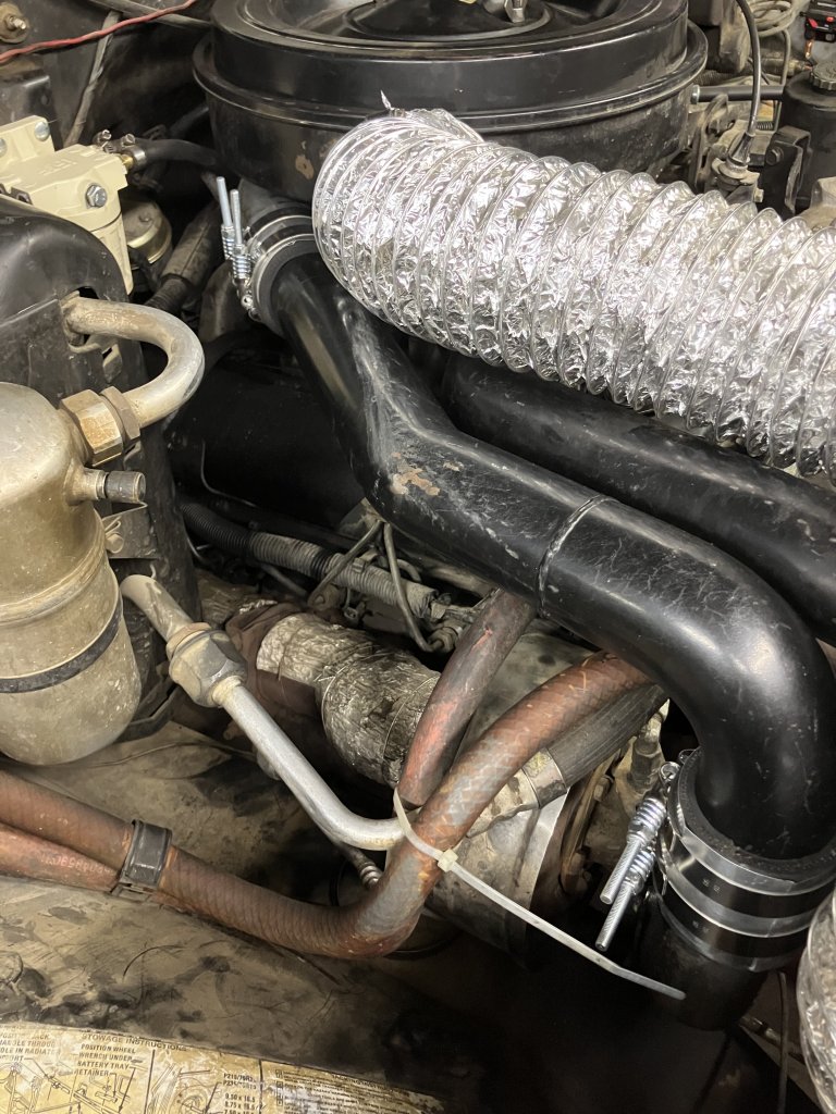

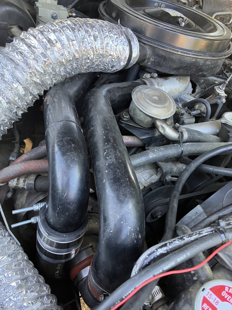

Quick update. My travels finally got me back to the truck yesterday. After sitting all winter (garaged) it started almost immediately. No more lost prime since ditching the WIX box fuel filter. I'm very pleased the spin on conversion held prime! We drove the RV here (toad-less) so good excuse to take the truck out last night for a Walmart run. That growly open exhaust puts a smile on my face! This morning I got some tools and went test driving. My new baseline is 5 psi boost at WOT. Negligible boost cruising. Pulled over and disconnected circuitous air inlet to turbo then drove again (paved roads, no dust). Boost bumped a bit more to solid 5+ and possibly as high as 7 psi peak. Obviously I didn't leave the turbo unprotected so reattached that crazy air filter pathway. The whole intake needs replumbed (custom plenum). Rather than hack what's there I plan to fab from scratch. That way I can put it all back if needed for whatever reason. Lots of decisions. Custom box for rectangular filter or open cone, for example. How much steel vs alum for hard lines from turbo to intake will mostly turn on my abilities. There's a smaller tube currently piped inside the OEM air filter that smokes a bit. Some kind of EGR? That needs research first then probably an inlet port between the new air filter and turbo. Meanwhile, it's running so much better just removing that stupid exhaust restriction that I'm satisfied for the moment. Besides, other life priorities means a narrow window of opportunity to do more now. At least I get to drive it home (AZ) when we leave SoCal this trip. Exciting stuff. I guess that wasn't such a quick update. shrug
KamperBob
Mar 16, 2024
49
74
Somewhere USA
Robert
k30
6.2

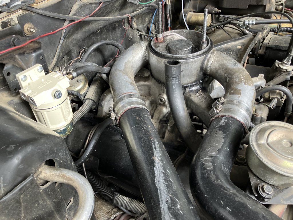

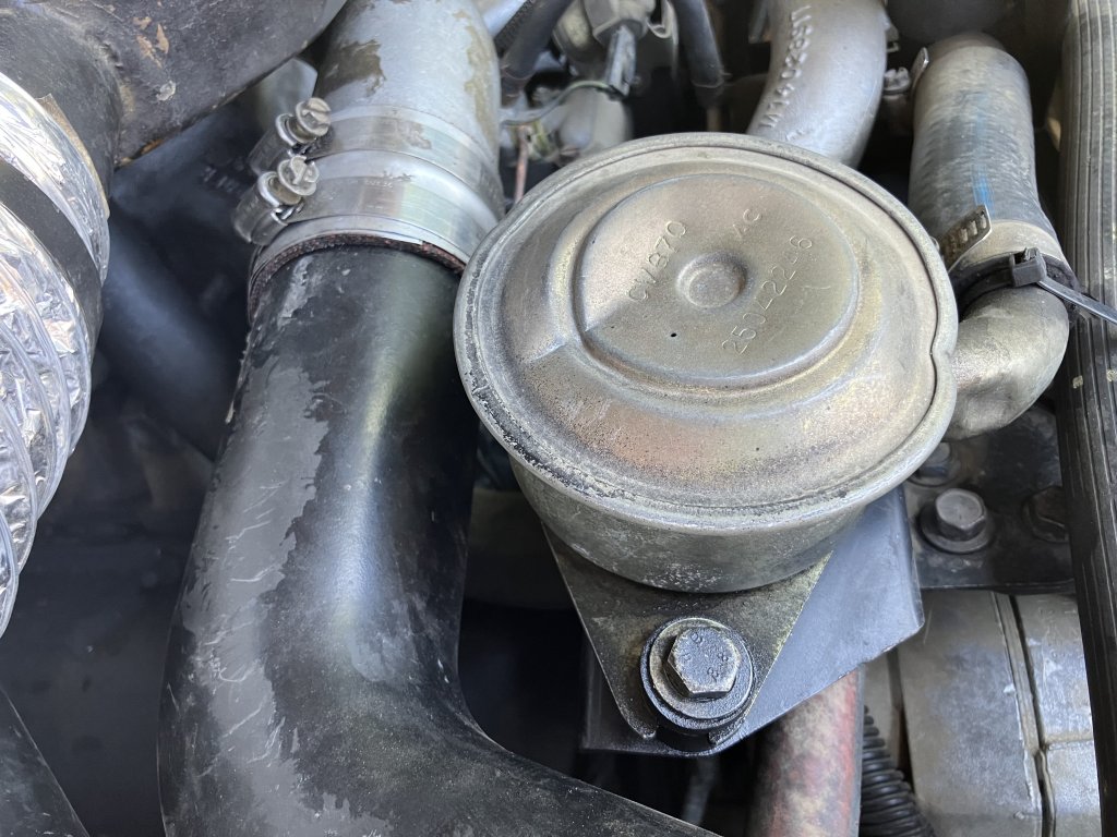

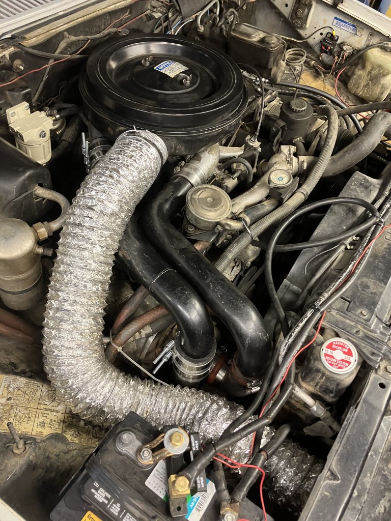

A couple pix of the turbo plumbing and that crankcase vent or whatevertheheckitis that pipes inside the OEM air filter. It's a small hose maybe inch or so ID...
