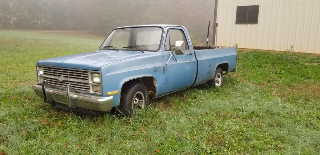

What do You want the truck to be? this should guide your decisions, as well as your budget

Figure out your budget (then add 50%, trust me) then figure out what you want it to do, then research how to make it do that for your budget. As mentioned it doesn't need to be LS swapped, but for a reliable fun cruiser fuel injection and overdrive are a must, and it'll need gears since you're lifting it.

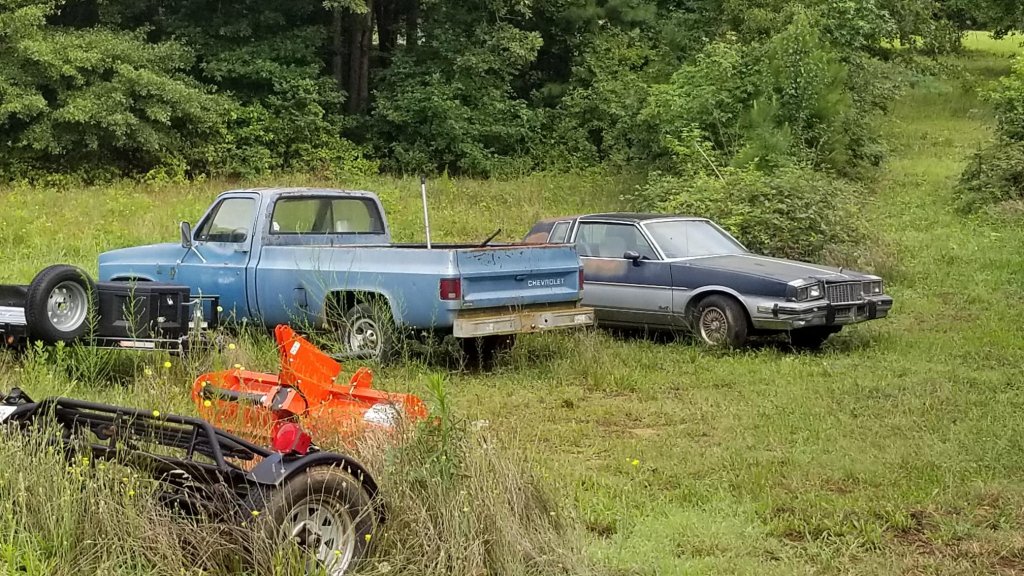

That looks familiar! Check out Goat's Garage on Youtube and see ours. We put rear disc brakes on it. Had to rebuild the TH350 and now it looks like the V8 in it at least needs a rear main seal. Gotta check compression and see if it runs before we commit to that ordeal. Got a 350 on a stand that could go in right now, but may be savinig it for another project. Do whatever makes you happy!

Fuel injection and overdrive? Not needed. Guessing a malfunctioning q jet. I would have had it rebuilt. That lift will create as many problems as it solves but it's your truck and your vision. Looks fine as is.

It looks like a solid start. All I'd do with it is put headlight bezels on, get it running good, fix any leaks, and make sure the AC blows cold. If you can achieve everything I just listed, you already have a better square body than a lot of people.
As for engine swaps, I'd keep that 305 running for as long as possible, it'll do everything a 1/2 ton truck needs to do. If you insist on a swap, a 5.7 Vortec would be the easiest "modern" option since it's based on the old school small block architecture and pretty much bolts in. A LS swap is far more involved and difficult, but it has been done many times.
Pay attention to your steering and front end components when installing a lift kit, it's easy to end up with a wobbly mess if you don't adjust things correctly or use the wrong parts.

Btw most of the truck is original paint (where the black primer is showing). Gray primer spots have been repaired or repainted.
