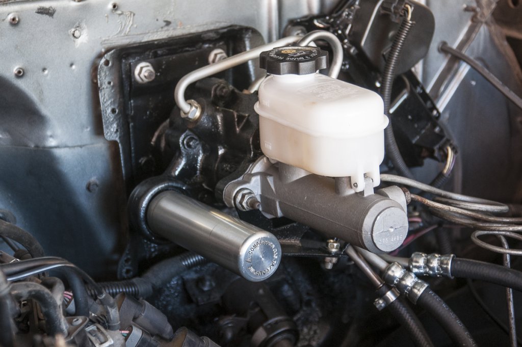

i use 1999 Sierra 2500 master, 1999 S10 reservoir (no sensor more oil), 2003 HD hydro, OEM C10 HD hoses... to upgrade my ugly iron OEM kit! :)
