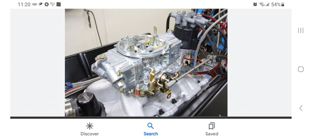

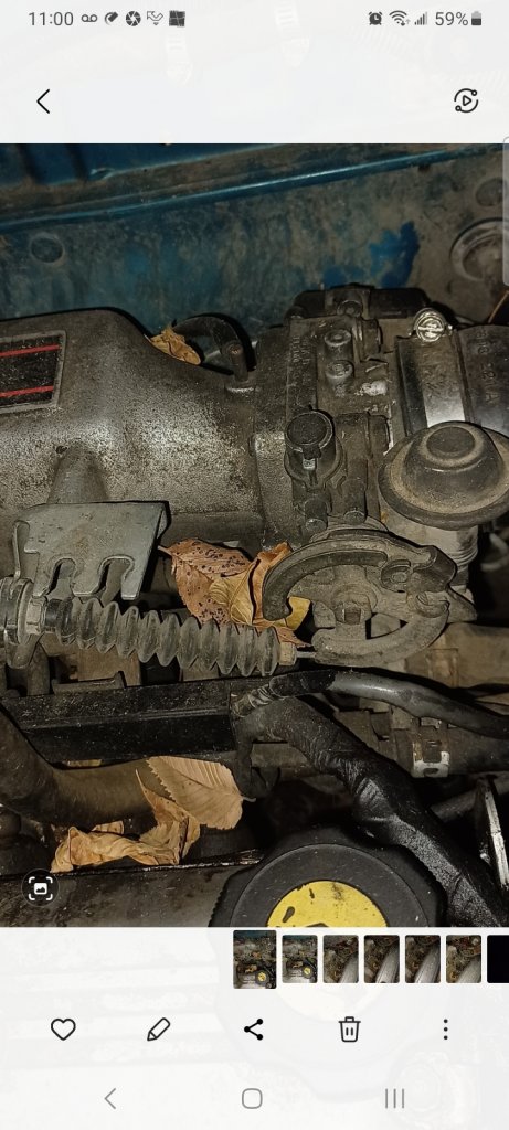

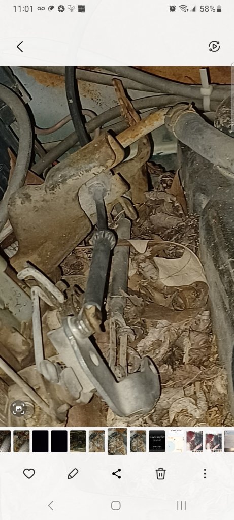

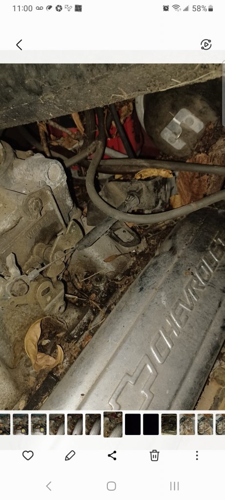

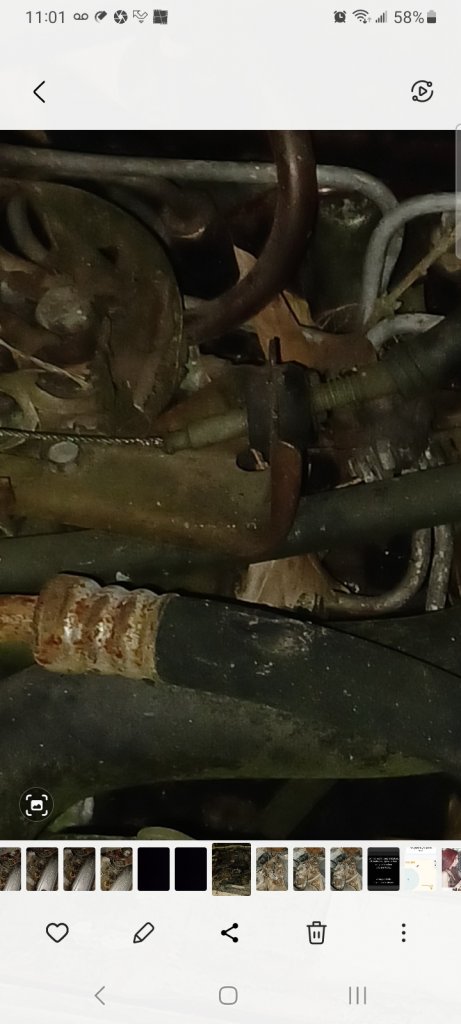

Pics. I can't se how it could be hard to reroute a cable. It's a cable,it's flexible move the bracket/ make a bracket to hold the cable so it lines up with your new carb. I'll find some pics or take some pics brb.Pic 1 north south pull 75 k I could move the cable mounting bracket to the left valve cover turn it 90 degrees now it would pull east west. Pic 2 VW Rabbit I could move that bracket to the valve cover point it forward and it would be north south. Pic 3 84 C10 I could move the cable bracket to the left valve cover point the cable towards the right valve cover and now east west. Pic 4 Ford festiva, east west,turn the bracket 90 degrees move it back it now pulls north south.

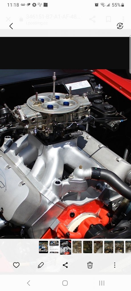

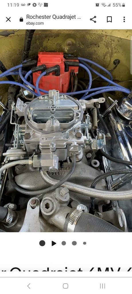

Better examples. Last one is sideways
