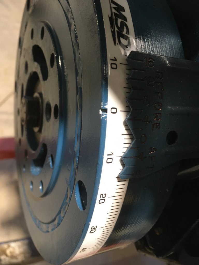

Either that, or buy a tape for the HB with the timing marks on it. Use clear paine to keep it on.

Looks like these BB Olds engines like to have a total advance of 34 to 36 degrees around 2,800 RPM (16 initial, 20 in distributor), but they said to check total first, then see what initial is at. I did see on an Oldsmobile forum people mentioning using the timing tape like you posted a picture of, or use a dial back timing light.
I should probably purchase my own dial back timing light anyhow, I would rather not be taking stuff apart to put tape on the harmonic balancer. Not to mention, this will not be the last engine I build, or tune in this manner anyhow (and I like cool tools anyhow!). I have a Flathead V8 build coming up at some point, and will be helping my brother degree the cam in his 56 Pontiac Chieftain engine so the dial back light would be handy.
