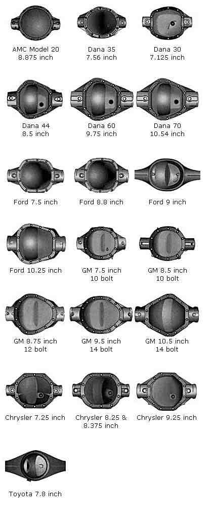

It was always my understanding, that the "bolt #" designation, came from the number of bolts on the ring gear, not the cover. If this is the case the 9.5" sf 14 bolt has 12 bolts holding the cover on. Perhaps this is where the confusion is coming from?
CSFJ
Jul 1, 2014
6,160
5,178
Hopefully the image posts.

No they are called by the number of bolts on the cover. 10 has 10 12 has 12 and both the 14 bolt SF and FF have 14 bolts on their cover.
Plus the cover is quite different from a 12 to 14 bolt SF
A 3/4 ton 12 bolt axle is the same SF design. the only difference is that they have 8 wheel lugs on the axle flange.
