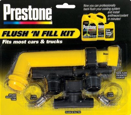

47,215
9,497
I kind of like that cheap Prestone flush kit too. I'd still do the Chemical flush too, but then I'd prefer the backflush T in the Prestone kit. It not only gets the heater core since you're using a heater hose, but it pushes the water backwards through the system. At least so I think it does. It would seem to make more sense to me to push crap backwards out of the holes instead of trying to cram it on through and possibly wedge the junk in the tubes. :shrug:

I just pluck mine of the shelf at the Walmart TLE. Those things seem to sell like hotcakes at my local store. I like it. It's always there if you want to flush it again, and it gives it some oomph to clean it out good. The chemical flush is a good idea. I've never used it because neither of mine were that gnarly when I got them, but they were definitely dirty. I attach a section of old garden hose to the spout and drain it into an old cooler so I can see the carnage. It's not messy, either.
47,215
9,497
Agreed. I use the hose too. I've bought one of these kits just for the radiator spill out spout and the hose adapter. As far as the T that you put inline to a heater hose, I've collected a few of those from Pull A Part so I had spares in my parts bin. Get a new to me truck and I decide to to do the flush, I go to the part bin and install it and use the same hose adapter and spill spout that I keep in my tool chest in the specialty tools drawer.
