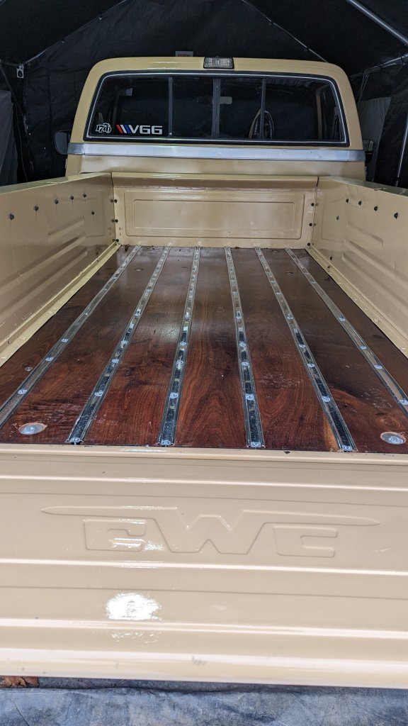

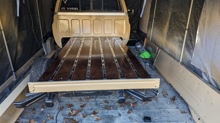

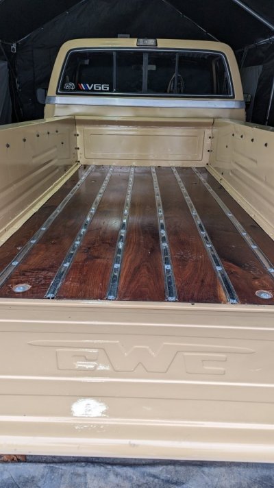

For the long bed stepside there are 8 bolts total same as a standard bed. There were 4 of the 5 larger rails that lined right up with the factory frame holes and bolt through the frame with carriage bolts and offset washers. The 5th big rail just helps support the bed wood. 2 smaller rails just bolt to the wood. It was super easy to do and I just pieced it all together bit by bit and put it on by myself. I can go more into detail if someone is lost. I ended up only using 6 of the 8 bolts as well because I moved my tank to the rear and didn't want to drop the tank to get the last two in. Maybe a project for when it's warmer out. Wood stakes are coming when the weather gets warmer in PA. I need them to hide all the dents I missed on the top of the bed rails

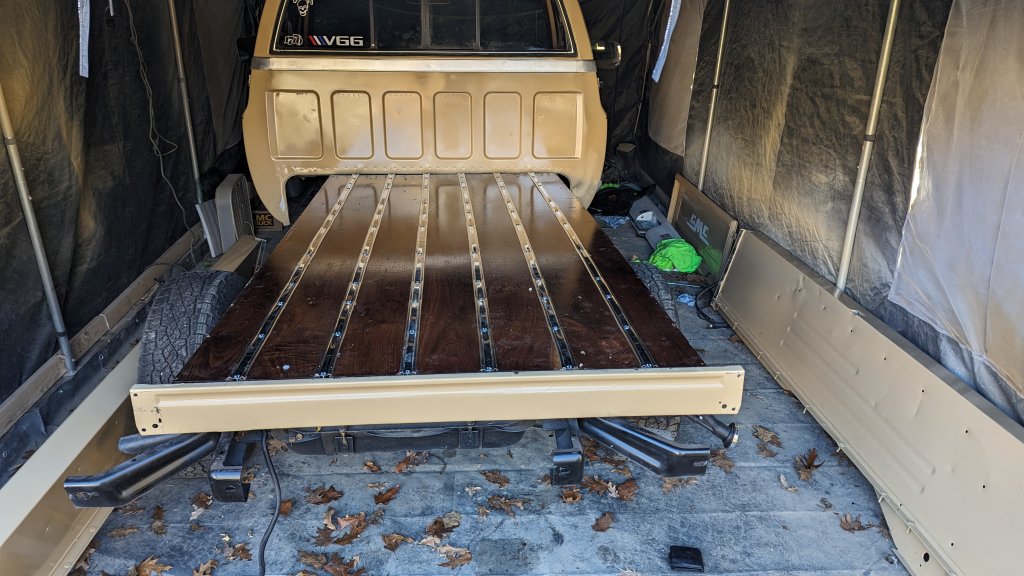

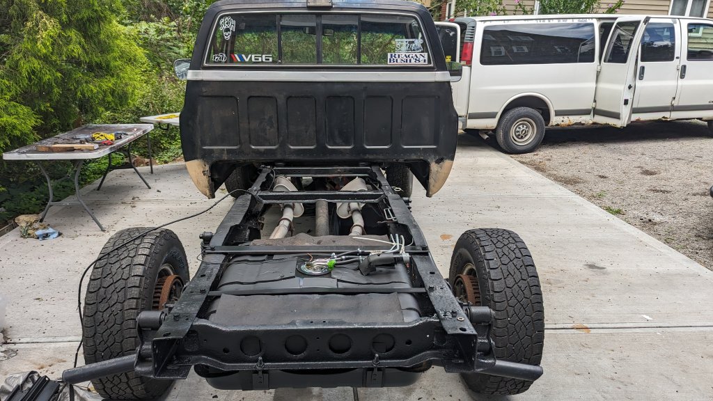

Here's an idea of what the undersides look like on steps and fleets. Similar bedrail layout same frame mount locations. Well minus the rust and missing chunks on the fleet side.

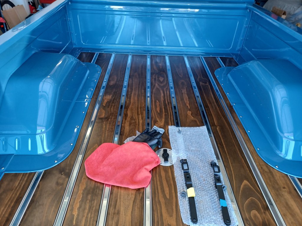

If you want hidden fasteners, you can tack weld nuts to the inside of the rails and put the 8 bolts in from the bottom. This is my son's with hidden fasteners.
