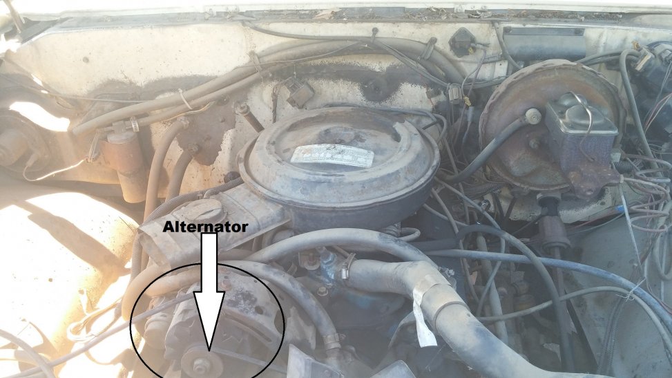

Here's a visual to help. :waytogo:

The pad behind the alternator is not 100% correct. I maybe but don't go off of that. Block casting behind the drivers head gives you a better idea.
But the difference between a 6 and 8 is big enough same as seeing a AC compressor vs not having one.
Not seeing any numbers, should I climb underneath? Or might I have to take a part of to find it? Other suggestions.
Thanks for everyone's help! This was a surprise to me!

You will likely have to clean off the pad as I'm sure it's covered in a thick layer of grease and grime.
No need to get underneath as it's on top where the block meets the cylinder head. :waytogo:
NO you wont find anything underneath. Behind the alternator where the head meets the block the block will stick out towards the rad about a half inch, it is a flat shoulder and there are numbers engraved into that shoulder. You often times have to wire brush off the grease and sometimes even the paint to be able to read those numbers. If the block has been rebuilt and they machined the block where the heads sit ( called Decking the block ) you often times will not see the numbers there as the will have been machined off.
