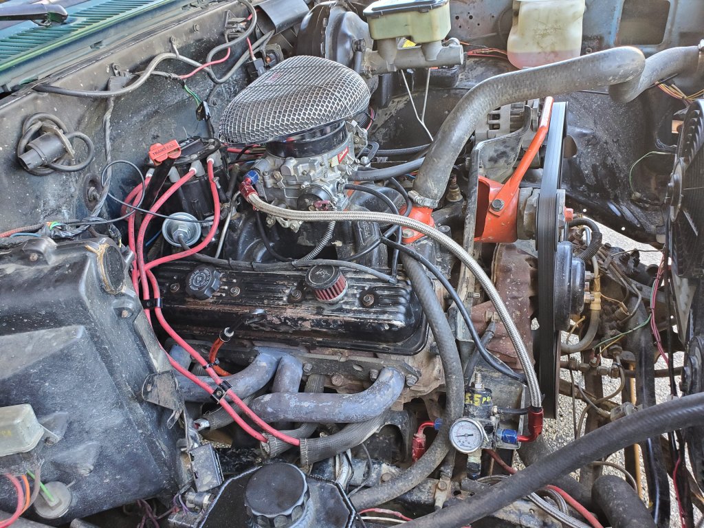

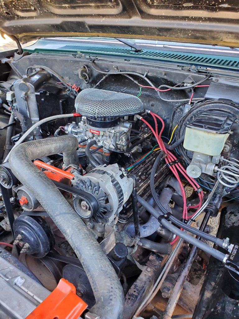

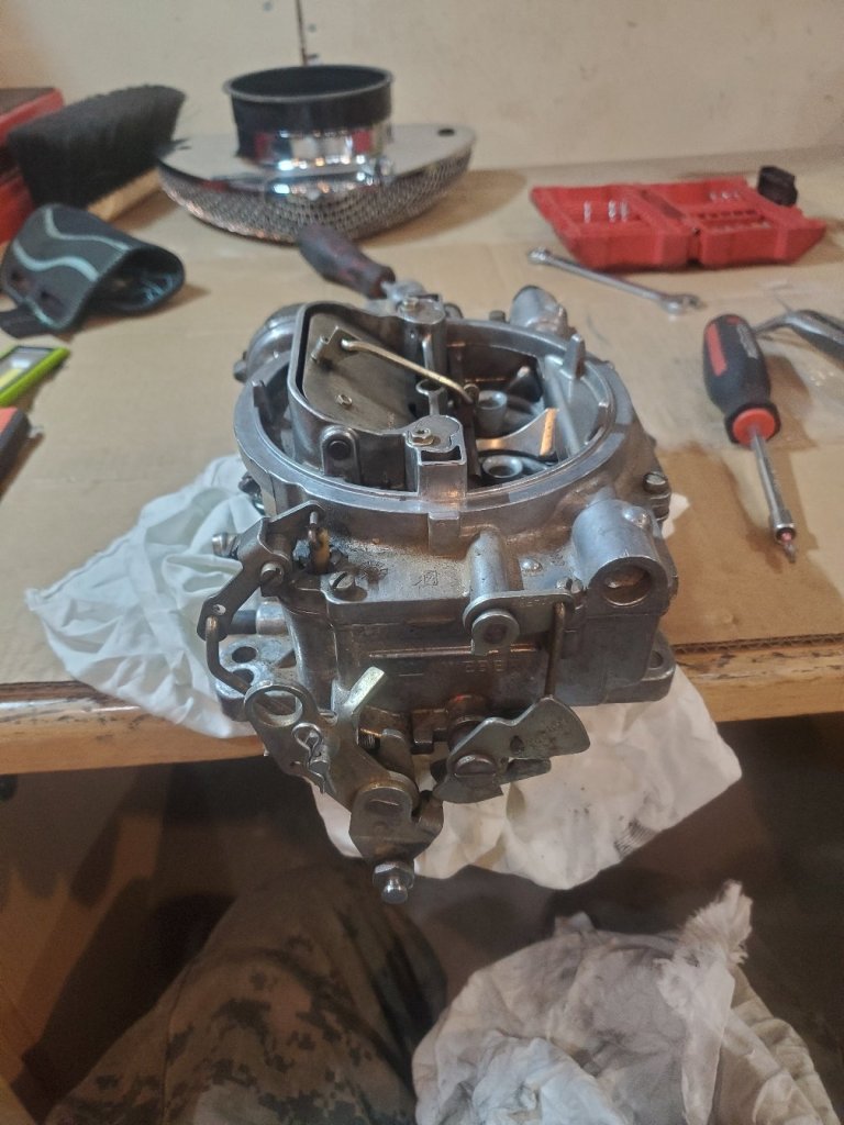

Ok, so I'm having a major issue right now and I'm out of ideas on how to fix this. Truck has ran great with my new (to me) motor transmission until I had to swap my mild performance to full out performance distributor. I adjusted the carb and timing once I made the swap, it ran good for a few days and now I've been fighting with it for almost 2 weeks. Idles good, got my fuel/air mixture good, drives good through the low intown speeds. Once I go to the highways speeds (70km/h +) the mixture goes super lean and pretty much stalls my truck out. Been trying to solve that and everything I have done has made little to no improvement. I've checked for vacuum leaks, leaky carb, changed out my electric fuel pump to a more carb friendly one, I've cleaned my carb and made adjustments to all metering and Jetts. Adjusted my accelerator pump. I've done pretty much everything I can think of and what I've been told in my repair Manuel's and everything. Anyone have any clue or ideas on where to look?
UPDATE- Resolved the problem..
BIG NOTE- always make sure you anything that needs vacuum to work to the correct vacuum line..
RESULTS- Had my fuel pressure regulator hooked up to the wrong vacuum line off my carburetor hence when hitting highway speeds I'd lose fuel in my mixture. No vacuum = no fuel pressure = no vroom vroom

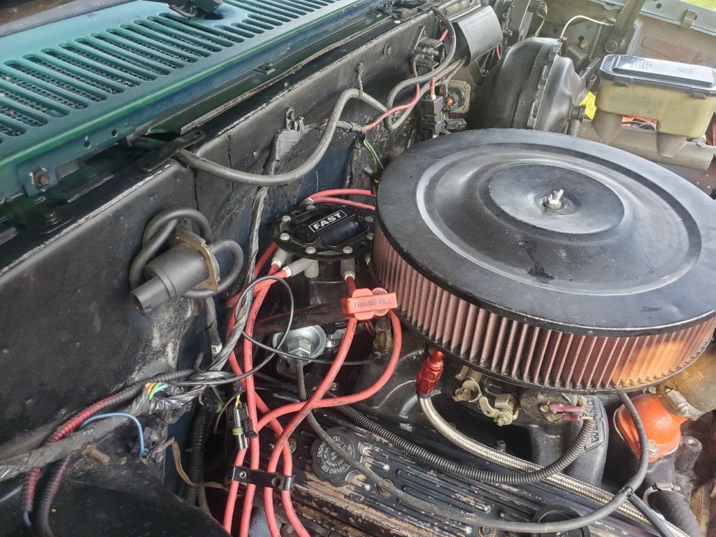

How do you know the mixture goes super lean at highway cruise? Could it just be starved for fuel? Did you change anything on the fuel system when you changed the distributor?
Is there a brand on your “full performance distributor”? HEI module, advance mechanism and other parts could be bad, even if it’s new.

Distributor is F.A.S.T. and it's running good. It's a fully adjustable advance setup. So I've though maybe it's advancing to far forward at those speeds.

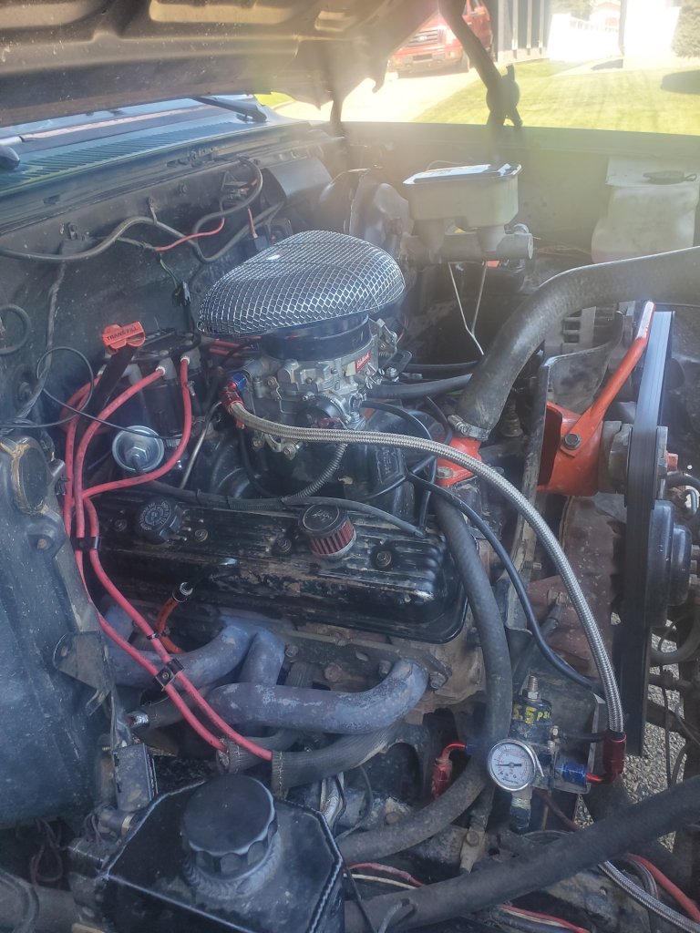

With thar fuel line at the carb, you have basically a rubber line making a hard 90* turn. I would correct that first.

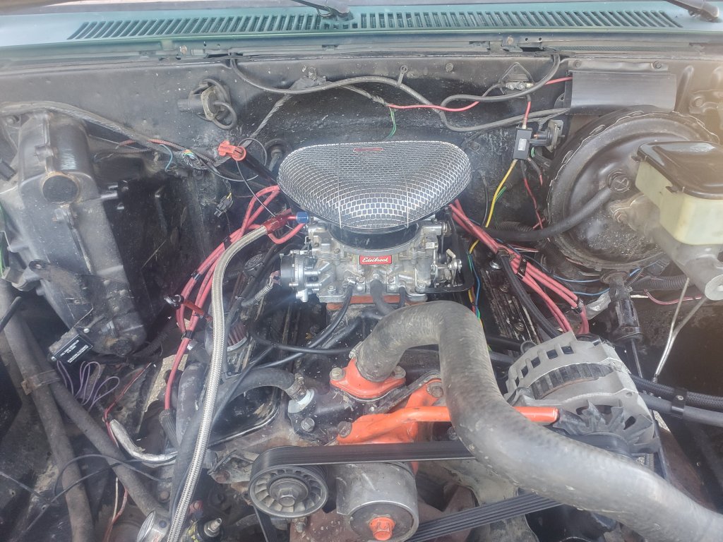

Well after all the heartache and ******** for 2 weeks. I finally realized that my fuel pressure regulator wasn't working right and I solved the issue. It was not hooked up to the correct vacuum line. So when I finally would hit highway speed my vacuum would drop right off and thus closing the regulator and choking my truck to death
