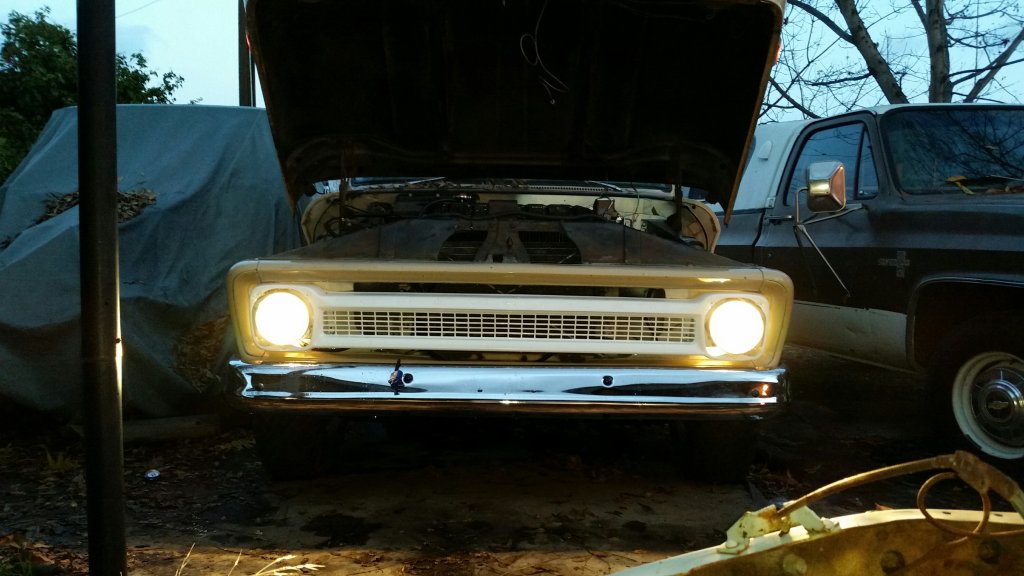

So tonight's report on the headlights. I got them adjusted properly earlier in the day but had a power outage at the farm so I had to run straight there after work, and then made my run north, which requires me driving that before mentioned curvy road both directions in the dark, in heavy rain. So no time for fog light install. I can firmly say the light is much, much better, but yes I can see the fogs being useful on the twists and turns at least. Also got the replacement +50 headlights from hella. My thoughts is they are fine. No tinted glass but seems to be a little whiter light than the regular bulbs. Probably won't buy them again, but I'll run them until they burn out.
@DoubleDingo I want to see better but not blind other drivers, I completely agree with that! One of the many reasons I didn't even consider LEDs. The hella kit has a much, much better light spread, and firm cut off line. Unlike the sealed beams we are use to where the bright part of the beam shines out and then whatever is left in the peripheral just blobs out everywhere the low beams on these hella lights with the H4 it's brighter where the headlights are aimed but there is almost like a hard cut off of light on the low beam so the light is nice and bright, and wider than the sealed beam, but does not go any higher than you aim them. That's the best way I can explain it. I'm also going to say pictures don't do it justice but here are some.
Above: This picture is taken in pretty heavy rain, heavy enough you can make out the beam of the lights a little bit, but plenty of it is hitting the road for good visibility.
Above: At the farm, the truck is facing down hill so you don't get the full spread of light but you can see the brightness well.
Below: head shot with the lights on
@77 K20 My headlight switch gets considerably hotter with 55W lows, vs the 35w seal beams, so for at least that reason I'll be happy to get the relay kit installed.

@SirRobyn0 That's looking good! Those are kicking out a lot more light to the sides than just about any sealed beam (those no longer made GE Nighthawks were the rare exception, probably just equaling these). Hella doesn't make their own bulbs... what they have is pretty good, but probably not worth going too far out of your way to obtain once these burn out. Whatever you're running will whiten up and brighten up more once they're getting full alternator voltage. Life will be shorter, but should be acceptable. If they don't last as long as you like, you can step back to standard brightness ones, but avoid long life headlight bulbs if you can.
My headlight switch gets a bit warm, too, but I think the wiring coming out of the dimmer switch gets warmer... mostly when I drive for long periods of time with the high beams on. I have 60 watts of low and 90 watts worth of high beams per side. I will be brewing up a decent relay harness here at some point, though I've been getting by with the stock wiring and just okay lights since most pavement is really sunbleached and it almost never rains here. I definitely coulda used more light out on the road when I was up in Montana, Washington, and Utah last summer.

I don't know what you had before as far as light distribution, but I know for sure this is an improvement. I am glad you started this thread, I now know which setup I am going with.
About the Hella bulbs. The standard set that came in the housings were marked GE. The +50% were marked Hella. The Hella bulbs are available on Amazon and cost roughly half the cost of Phillip Xtra visions, which are also on amazon. So I guess we'll see how it goes, but I've been so happy with the X-visions in my other vehicles I'd probably be likely to go with those.
Well I didn't take a before picture, but I was running Sylvania halogens, and I would describe them as very average for sealed beams. This is just so much better. Next week I'll take some high beam pics, I didn't think to do that last night. I'd really encourage you do this as it is just such a huge improvement. And if you do I hope you'll let me know what you think.
