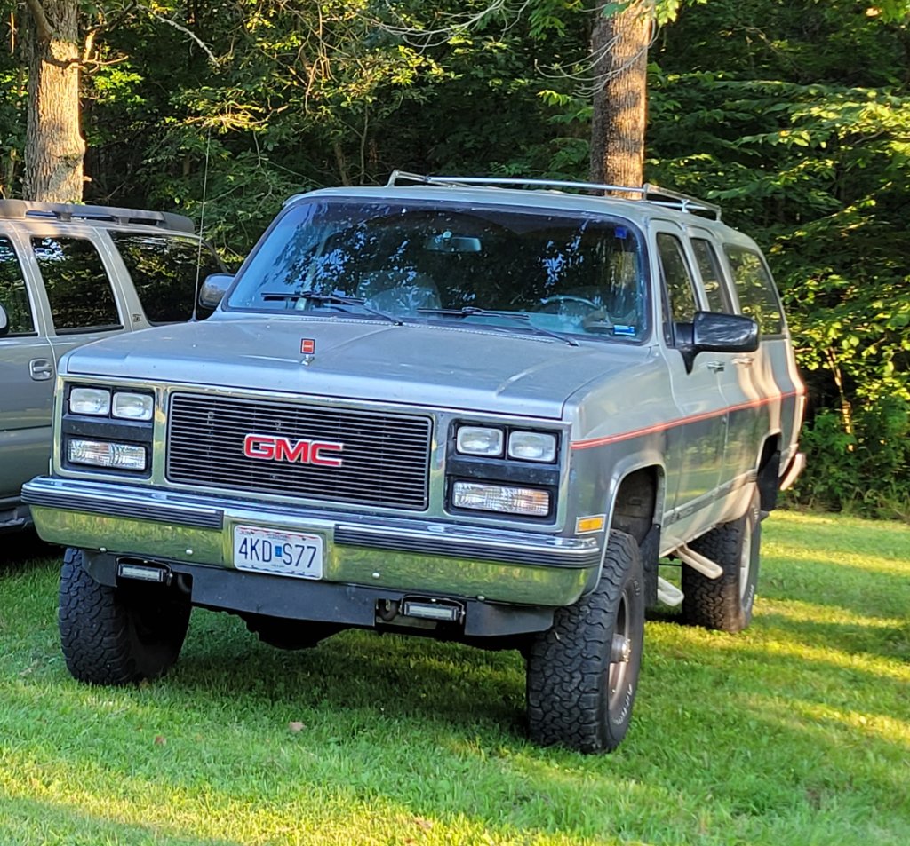

I have 2 Diode Dynamics SS6 wide pattern as fogs. they have a good cutoff so I can run them anytime. I have them aimed to fill in to half the low beam focus on the road in front of the truck. they are low key when off (don't change the front look much) and are very bright when on.
