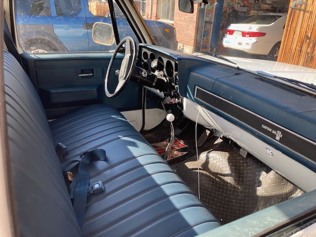

I'm 5'10". My seat is about right, but a little short to push clutch down comfortably. But, with my Hurst truck shifter, when I pull back to 1st or 3rd, its very close to the seat, so I don't know if moving the seat up will hit the shifter. I'll go try it today.
