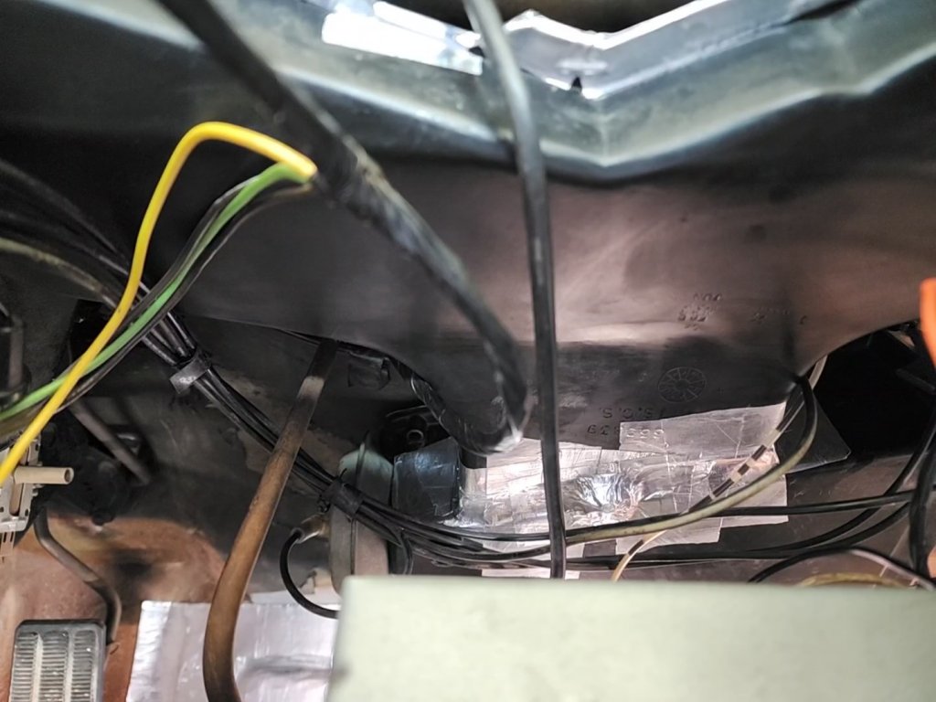

After recently replacing the (original brass/copper) heater core, I found that I too have a gap at the heater box up to the defrost vent junction. Did anyone have any measurable results of leaving the gap, or sealing the gap??

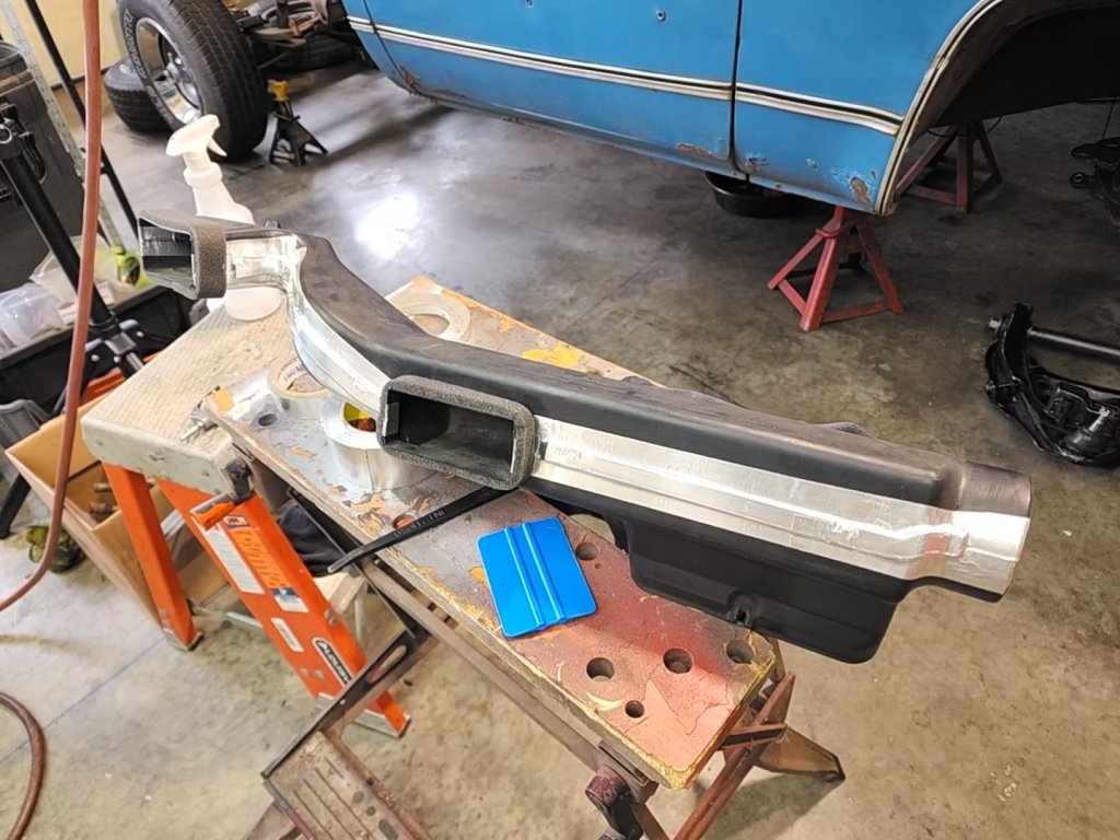

I noticed the gap when I did my heater core. I decided to close the gap with metal tap. I'm glad I did, so far the defrost is 100% better. I even sealed all the duct seems, probably over kill but I do notice a difference.
