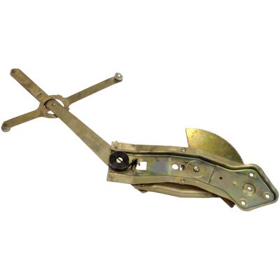

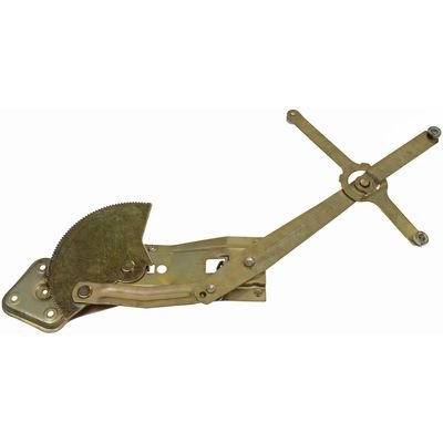

Not with an OEM system. Other than the circuit breaker, there is no feedback or any type of limit switch for raising and lowering windows. It will keep trying to drive up or down as long as you toggle the switch - let your finger off and it will stop.
In my experience the windows don't move slowly because of a weak regulator motor. Motor function does not taper off over time - they either are good or broken. Replacing the weatherstripping and channel run also rarely helps.
The primary cause of sluggish window up and down speed is due to excessive play in the nylon rollers at the ends of the regulator lift arms. Two of these rollers ride back and forth within the sash channel and another slides in the regulator rail. When they get too sloppy, they have a tendency to get cocked. So, instead of rolling smoothly along inside the rails, they just jam sideways and operation slows.
my regulator of the left door is new as you can sight in the top and bottom right of the left square corner hole.
my weather stripping was disintegrated, there is still an improvement with the new one, but i think is not quick enought mainly at the top end, i also put wd40 in the rail to see if it does improve somthing ans yes it does, i know it'll not last long.
