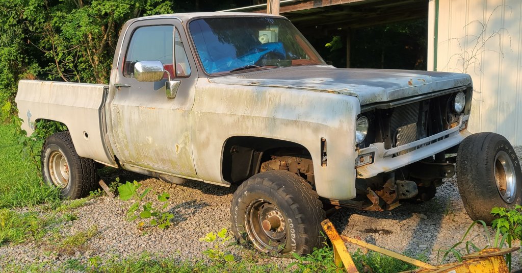

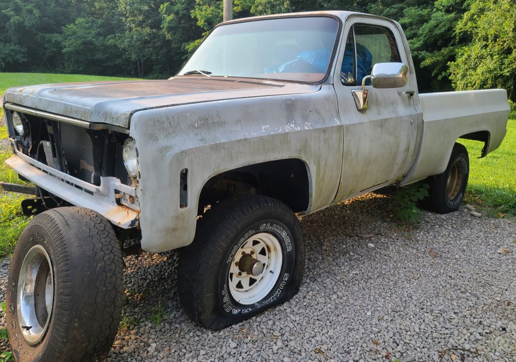

And consider ourselves lucky to have the truck which will remain in the family....few pics the day we picked her up !!

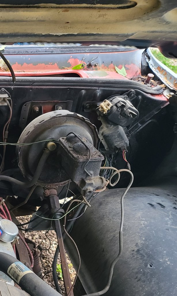

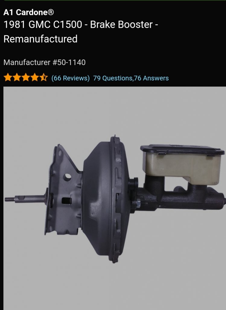

Im in the process of brake work.. I would like to know if anyone has put on a 1981 style brake booster and master cylinder instead of the older version pics as examples
