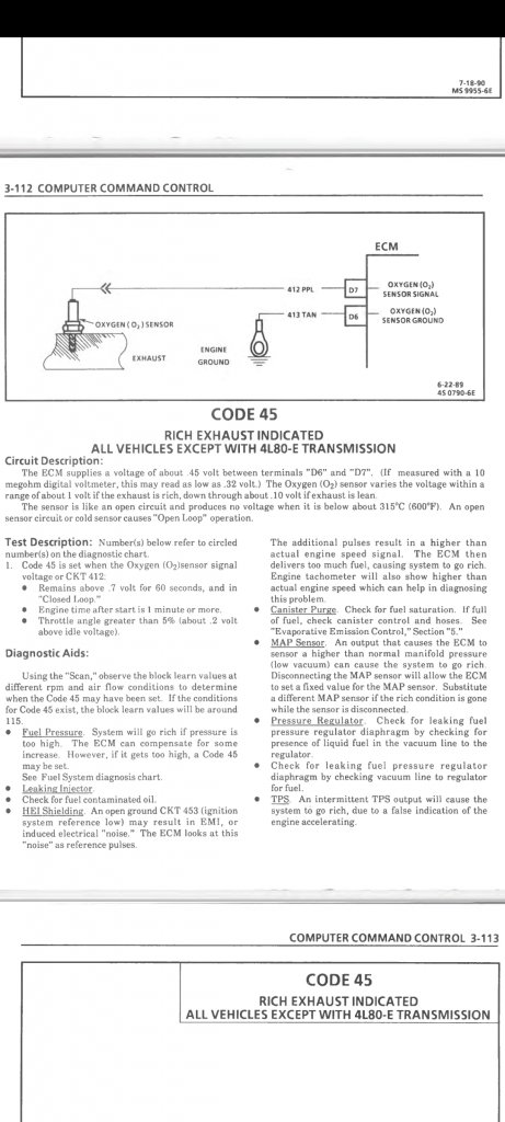

I am also having a rich condition. but only at idle, in park with no accessory load.
I think 9-13 psi is the spec fuel pressure range. seems like you may be over pressured or have a leaking fuel pressure regulator.
I am waiting on a pressure gauge to check my pressure
