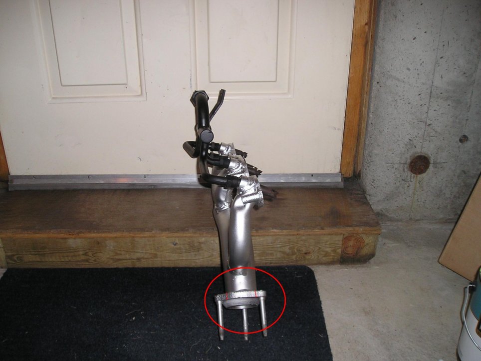

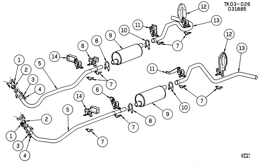

002 RING. Exhaust Pipe. Exhaust Pipe to Manifold. SEAL.
$31.50 15592451 at Nalley
This is for heavy duty emissions 350's and 454's with stainless steel shaped tube manifolds. Shown as item #2 below:

Thanks, but I'm looking for the one between the butterfly valve and the manifold. This one looks like the collector gasket, which is on the other side of the butterfly valve.

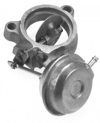

There is an adapter sleeve you have to use between the manifold and the top EFE valve body. You know what, before I go any further, is this the style of manifold and EFE you are talking about:

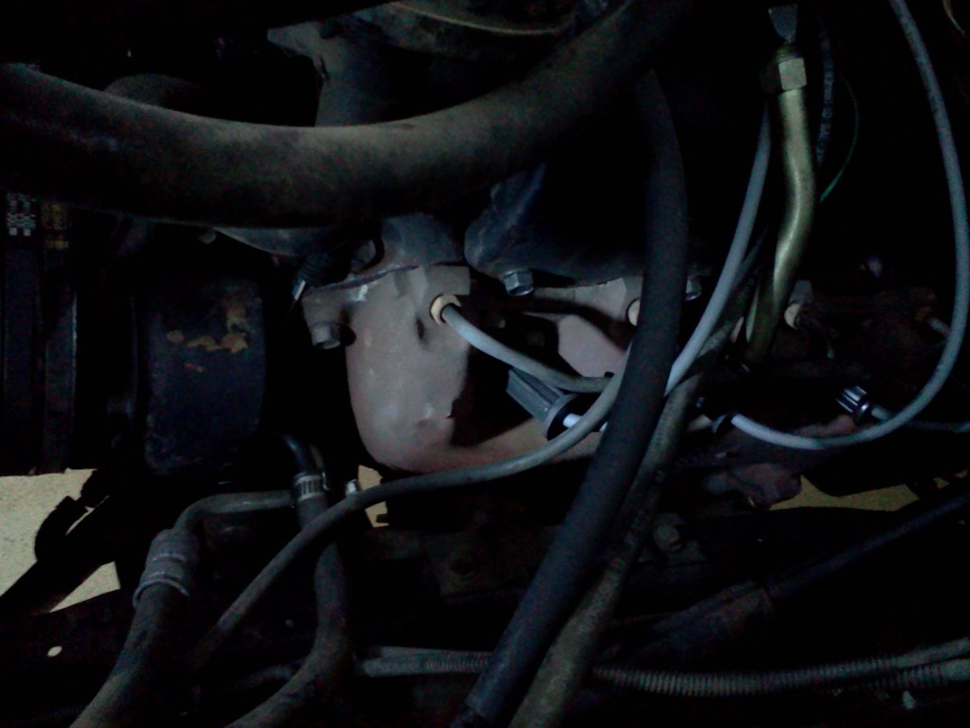

I don't think so, I'm almost sure they are cast iron log type, and the AIR tubes are a lot smaller. Don't want to say for certain until I can get another look at it. I'll be able to get out there and grab some pics in the morning.
The EFE is for sure mounted to the collector end of the manifold but not sure if it's that exact style.
Thanks,
-Josh

Nope, definitely cast iron logs...

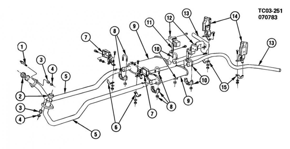

Below is the correct dwg and parts list for your exhaust system (cast manifolds) - from Nalley GMC
http://parts.nalleygmc.com/showAsse...del=14565&modelYear=1986&ukey_category=19399:
Showing Parts that fit your 1986 GMC C25/C2500 SUBURBAN 2WD
exhaust system EXHAUST SYSTEM-V8; EXHAUST-LE8/454
H4D emissions identified by cast iron Exhaust Manifold.;
(LE8/454W)(W/CALIF EMISSIONS); (LE8/454W)(W/H4D EMISSIONS)
OTHER: EMISSIONS CONTROL,6-CYLINDER SPRING OPERATED EFE,8-CYLINDER CAST IRON EXHAUST MANIFOLD EMIS CONT,SPR OPER(H4D)
001 STUD. Exhaust Pipe
$5.01 12337934
001 STUD. Exhaust Pipe.
$21.31 88891746
SEAL,EXH PIPE. Required: 02
For: CK2,3(454W) (1983-1984) (1984 - 1984). $31.50 15592451
006 CLAMP. Exhaust Pipe. Exhaust Pipe Support. Exhaust System Attaching. STRAP.
STRAP, EXH PIPE LWR. Required: AR
STRAP,EXH PIPE LWR. Required: AR
For: CK1,2,3 W/2.50 INCH PIPE (1979-1984) (1984 - 1984).
For: P1,2,3 W/2.50 INCH PIPE (1979-1984) (1984 - 1984). $30.08 00379360
008 CLAMP. Exhaust System Attaching. BOLT. Exhaust Pipe. Catalytic Converter. CLAMP KIT. STRAP. Exhaust Tail Pipe.
$13.87 15712422
010 CLAMP. Exhaust System Attaching. U BOLT. Rear.
$14.98 15973623
014 Exhaust Muffler/Resonator. SUPPORT. HANGER. Exhaust Muffler.

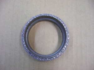

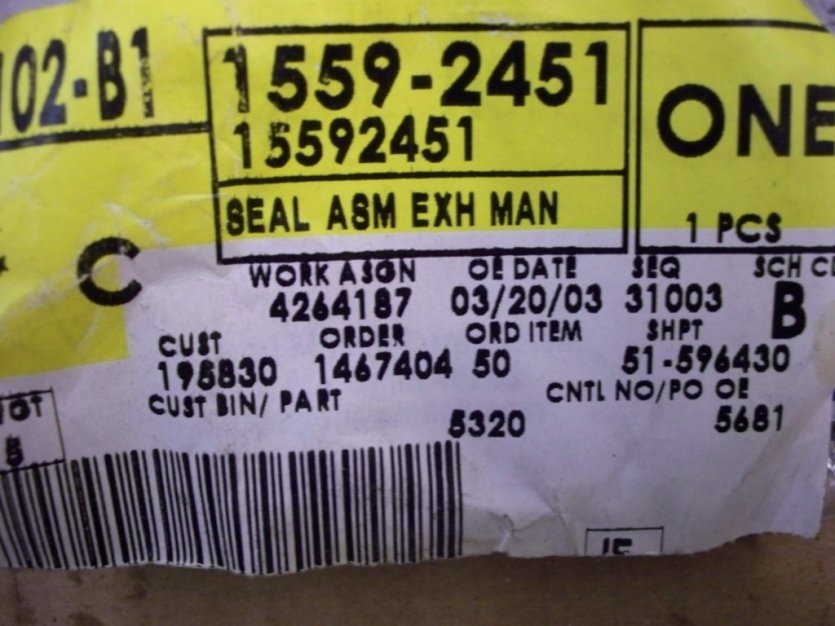

Then you can use the part number from Nalley's (GM part 15592451 as shown above) to try and find a better price. A quick search (I stopped after the first listing), came up with this NOS part from East End Liquidators. It's only $1 cheaper but Google showed plenty more results you can pursue:
We are located at:
69-71 E. MAIN ST
PLYMOUTH, PA 18651
UP FOR SALE!!!
BRAND NEW OEM!!!
EXHAUST MANIFOLD PIPE SEAL
FOR THE FOLLOWING:
1986-1987 BLAZER
1985-1991 C1500 2500 3500 SIERRA SUBURBAN
1993-1996 DELIVERY TRUCK
G10 15 20 2500 3500K VANS
GM PART NUMBER: 15592451
MSRP: $33.84
-40%
OUR PRICE: $20.00
PLEASE CHECK WITH YOUR GM DEALER TO MAKE SURE THAT THIS PART WILL INDEED FIT YOUR VEHICLE.
ANY QUESTIONS PLEASE ASK
THANKS FOR LOOKING :)
STOCK # - KMK276FRBOX1
PLEASE BEAR IN MIND THIS IS A ENUINE OEM PART, NOT AN AFTERMARKET PART, IT IS NEW IN THE PACKAGE AND ONLY OPENED TO BE PHOTOGRAPHED.
Payment:
I prefer paypal but I will accept all major credit cards
Shipping:
We ship USPS Priority mail.
http://www.eastendliquidation.com/servlet/the-482/EXHAUST-MANIFOLD-PIPE-SEAL/Detail

I got one from Auto Zone for a 83 for $2.00 dollars. The butterfly in the pit. looks the same.

There are two sizes, I'm sure he has the bigger pipes. Also that seal has a metal backing ring that slides up into the manifolds. They are not easy to find.
