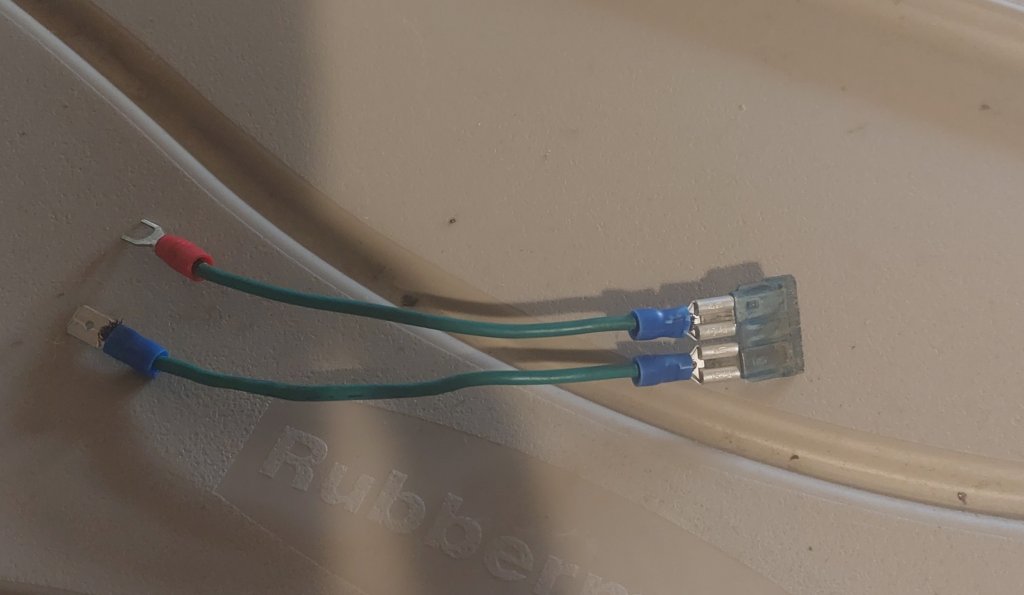

I had to do some work on the D.D this morning,which involved needing a jumper wire. Some know,some don't,so I'm posting when you are exploring,making jumper leads to test things etc. Crimp 2x1/4 female connectors onto your lead. They will push firmly onto a fuse,and supplying power in the wrong place,providing power to a shorted component or shorted wire will result in a burnt fuse,not a burnt wire in your dash harness etc.

^^^^^^^^^@Ricko1966 that's good, now show me one for glass fuses??^^^^^^^^
