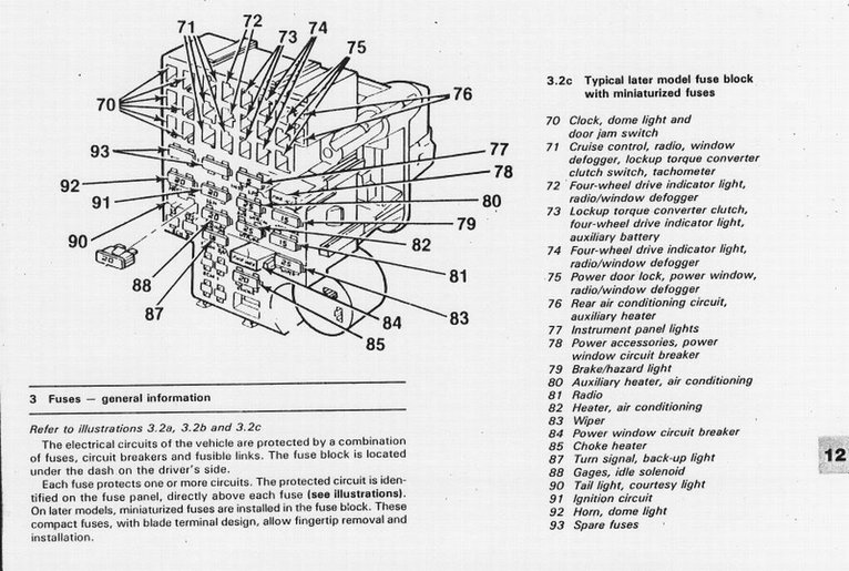

So most of lettering and numbers have worn off my fuse box. I want to make sure everything has the proper fuse and was hoping that someone might have a picture of a fuse box with the proper fuses. I have an 81 c2500 with electric windows and locks.
Also my left turn signal indicator stays on when the headlights are on, works normally when headlights are off. My turn signal works fine otherwise. I've replaced the bulb based on advice I read earlier, no change. I'm confident in the cluster and I'm not sure where to go from here.

Here's a diagram for an '81 truck. Double check to make sure it looks visually correct. Sounds like a short in your turning light. Make sure good contact is being made between the bulb and the socket, it's the correct bulb, there's good ground, and the bulb's not in there backwards. My car did that, and the bulb was in backwards. I had done that many months ago mistakenly because it lit both filaments and looked better, but it screwed up the back and forth between the light in the bumper and the one in the headlight assembly, and it made the turn signal arrow on the respective side glow whenever the headlights were on unless I was signaling in that direction.

I'm fairly certain that the fuse block shown above is for a later model. The giveaway is that there is no socket for the hazard flasher in the upper LH corner. It wasn't until 1985 that the hazard flasher was moved from the fuse block to the "Convenience Center".
Here is the fuse block wiring diagram from the 1981 Service Manual. It is pretty hard to read:
But below is the FB dwg from the 1983 Electrical Diagrams book. It is much easier to read and a careful comparison shows that the fuse socket designations and connected wiring are the same as 1981 (1982 was almost as sucky as the 81):
And here is an image of an actual 81-83 FB:
The only difference in this picture is the addition of an ECM fuse. It is most likely not included in the other drawings because it was only used with California emissions packages.
If you posted a picture of what your fuse block looks like, we could offer you a more definitive description of what fuses go where.

Thanks, that is very helpful! Here's some pictures of mine. Sorry about the quality and angles, was quite tricky to get my phone to play well and the brake line for the trailer brakes was in the way. Looks like the original owner added more to the wiring than I thought.

Yep, you should good using the dwgs above or the images below. Between the three of these you should be able to identify the intended service for each fuse clip. Disregard the ECM BAT slot:

Sorry about that. I looked for a fuse diagram for an '81 truck, and this is what came up most specifically. In my defense, I thought it looked fishy because of the flasher issue, but I don't have an '81 so I trusted it. I hope you get it figured out.
