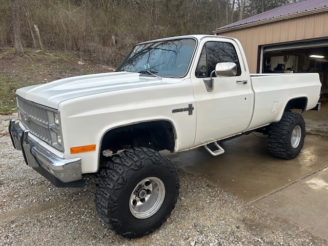

My question is: What size fuel tank do I have in imperial gallons ? (that means what we call a gallon in the USA)
(truck is a duel tank 1982 K10 LONG BED. Only driver's side tank works now)
Gauge on 5/26/25 read just over 1/2 tank. I stuffed it full and got 14.25 gallons in. The gauge was pegged past full.
This would mean I have about a 28ish gallon tank if the gauge is accurate. 14.25 gal x 2 = 28 1/2 gallons)
*Brand new fuel gauge that was pegged at 3 o'clock upon installation, then magically read just over 1/2 tank a few days later.
Google is all over the place with the size of gas tanks from 16-25 gallons.
Help ?

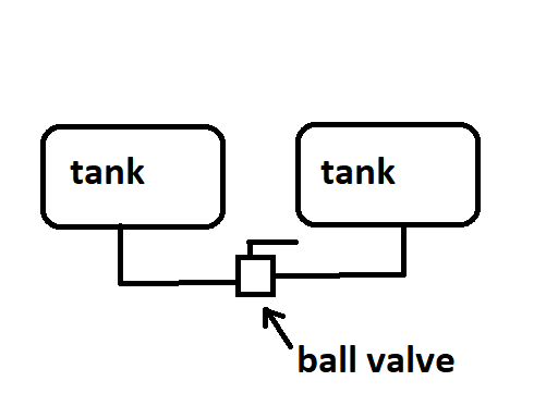

I don't think there is any way to answer that question from my chair. I don't think the VIN in or glove box tag will tell you wither. So without removing one of the tanks and draining/refilling then .... Oh wait, assuming that they tanks are the same size, why not drain the non working tank and then go to the gas station and fill it all the way up to see how much it holds. Actually....
I would take both drain plugs out of the tanks (assuming they have them) and run a pipe between both of the drain holes, with a ball valve in the center to isolate the tanks. Then drain and refill the non working thank. At that point you could open the ball valve and let the good tank refill itself with the non working tank as needed. Or you could keep the non working tank isolated and only use it as an emergency fuel supply in case you accidentally run out of gas on the main tank.

@Edelbrock , drain plugs? Haven’t ever seen a drain plug in an OE fuel tank on a light duty vehicle. They don’t put plugs in them.
To the OP, short bed =16 gal, long bed = 20 gallon. I don’t think there was ever a deviation from that but icbw.

Not sure about the drain plugs. I have owned older vehicles that had them from the factory, but they were Ford cars. Not sure if GM did that at all. Just got to climb under there and check. Or the drains could be added.
