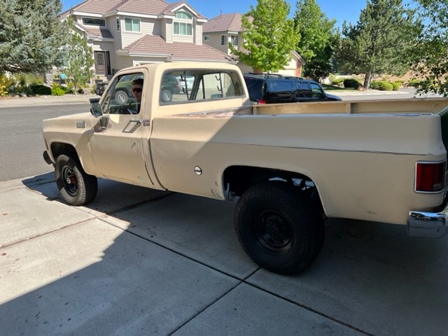

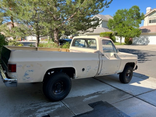

Update, We changed the fuel tank switch this weekend and the fuel gauge is still not reading. So the sending units have been replaced, the tanks, and the fuel tank selector switch. It is ready to go to paint this weekend in time for Hot August Nights in Reno.
