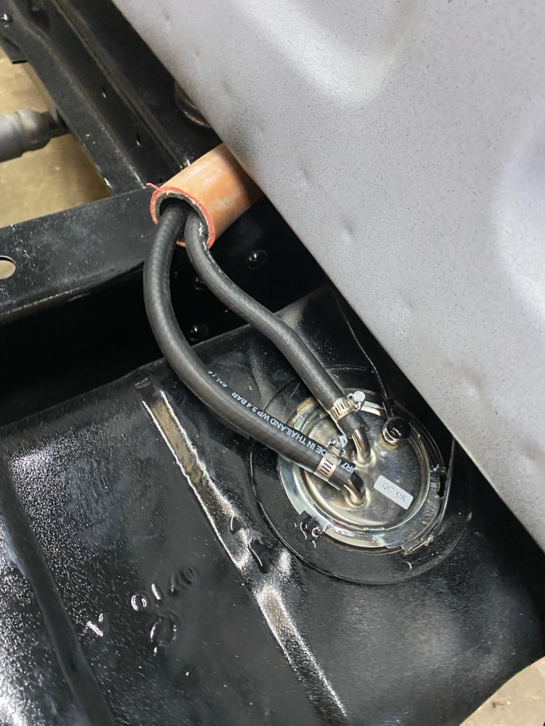

@SquareRoot and anyone else interested. This is what a left side sending unit in a right side tank looks like. As you can see it is possible to that and have the rubber lines neat, organized and safe. Going on three years like this so far and hasn't been a problem.
Nice. Thanks for sharing!

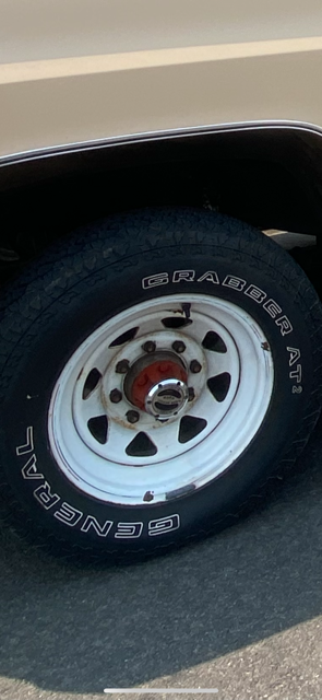

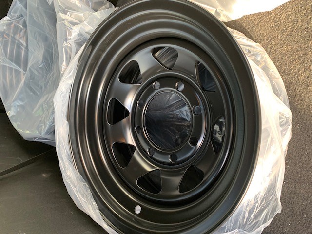

Thanks, this is great info. It sounds like it could take a minute to diagnose but we will try this first. A picture of the rims back from powder coating.
