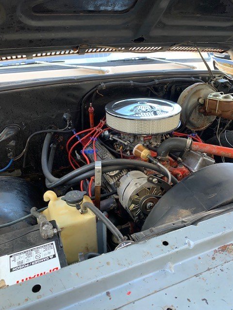

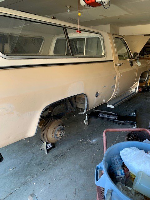

Thanks, I included a couple of picks from this past weekend. The body has very little rust. We are going to drop the tanks this weekend and determine what to buy. The rims should be back from powder coating Friday and the tires should be in Thursday. I will post a couple more picks once the tires and rims are back on. The rims are getting powder coated cardinal black.

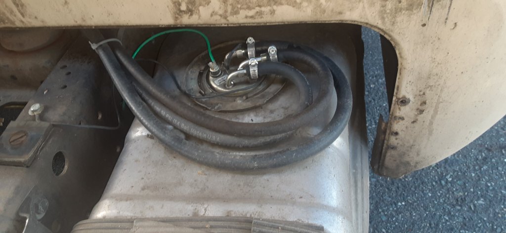

That's actually right and someone else mentioned that they are different side to side. And truly they are. However most aftermarket manufactures these days only make one. As you said most commonly they make the left side only, and putting it in a right tank really isn't an issue the fuel line outlets face the wrong way, but that can be dealt with by using slightly longer hoses to run the line behind the sending unit and then to the metal frame lines. It might sound a little less than ideal, but in practice it works just fine. If I think to I'll lift the bed on my truck and snap a pic of the right side sending unit as mine is set up that way and has dump kit on it so it's easy to get a look at.

@SquareRoot and anyone else interested. This is what a left side sending unit in a right side tank looks like. As you can see it is possible to that and have the rubber lines neat, organized and safe. Going on three years like this so far and hasn't been a problem.
