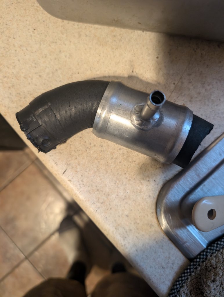

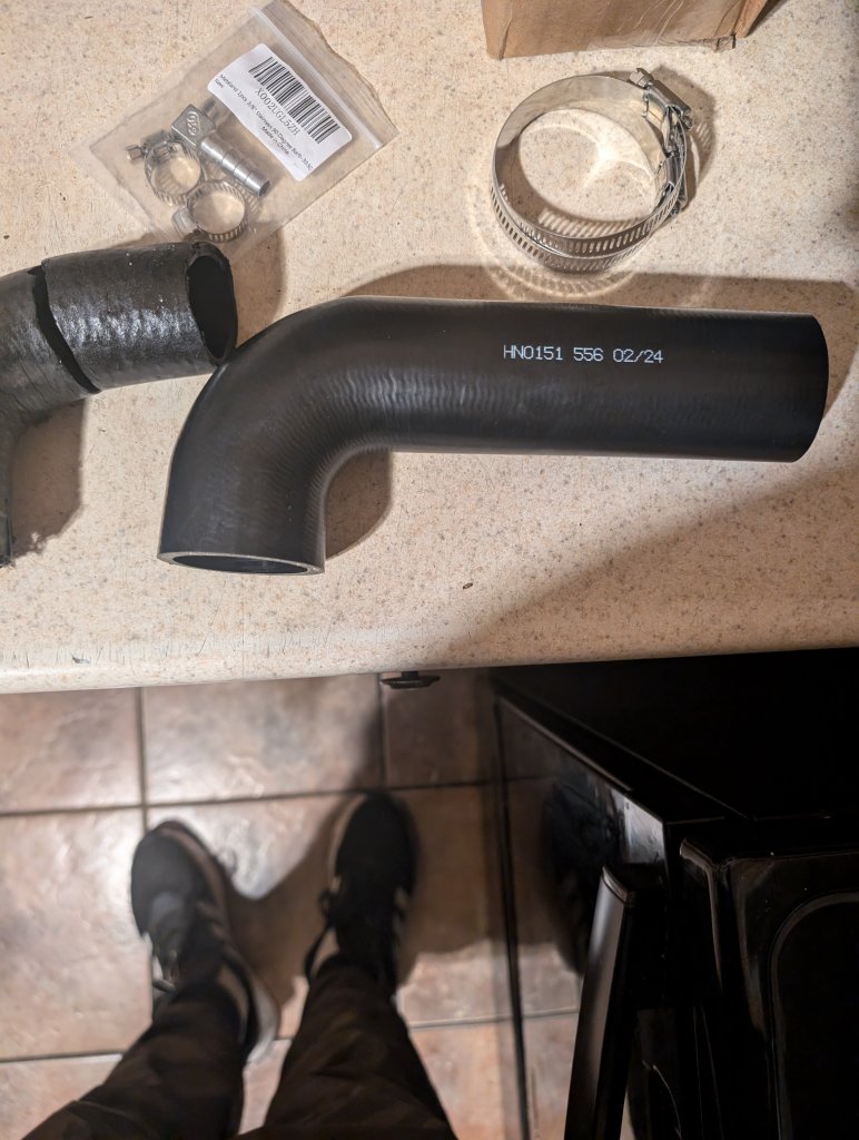

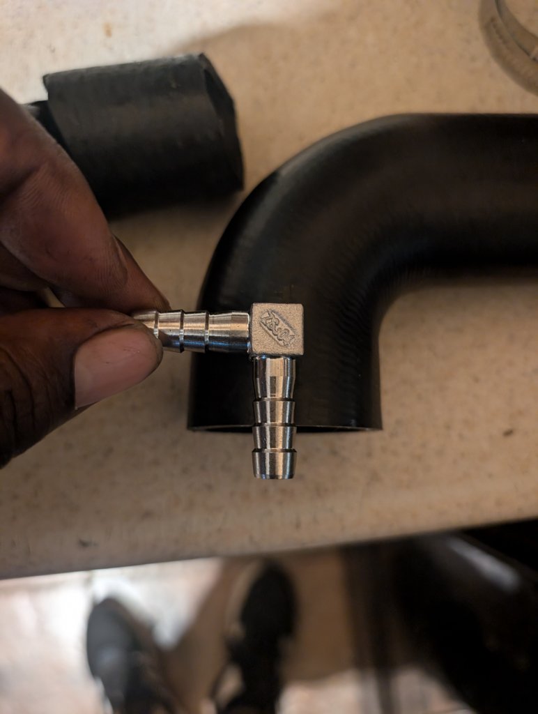

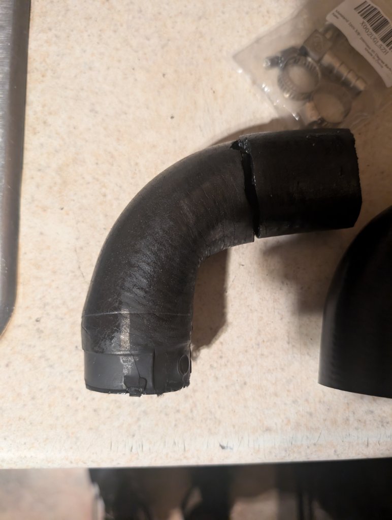

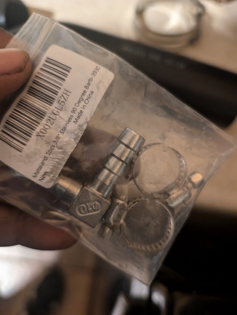

So, here is where we are. After buying the moroso fuel return line kit for $75 bucks, I attempted to install it and failed. 1 reason was because the adapter hoses were too thick to get on the filler neck and secure properly and 2 because the filler neck is the wrong size. I now have an in line fuel pressure gauge after removing the filter on the engine bay and have a full 3/8 return line running to the rear of the truck. The plan is now, with the correct filler hose, to use this 90 degree 3/8 barb and plumb it into the filler line and plug that return into that and it will dump directly into the tank. Wish me luck.
