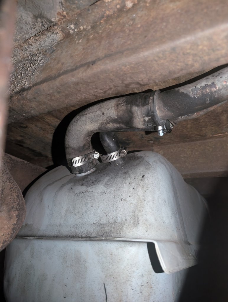

I am in the final stages of finishing up on this project. One of my last 2 missions is to resolve the vapor lock. I plan to purchase the WIC 33040 fuel filter with extra output for return..my thoughts are to route that return to the tank area and create a snug brass fitting on the rubber portion of the vent line.
Good idea or bad idea. I am attaching a pic.

Pic of tank and fill line and vent line beside it.

I really think the brass fitting in the hose will leak.
Find a piece of tubing the correct size, put a nipple in the side and splice it in to the vent hose.
I think someone actually makes a tube like I described but I can’t remember who it was.

You could also just change your sending unit to one with 3 ports. My ‘75 already had one, and when I replaced it I found they were stocked at some AutoZone stores. I don’t recall the price.
I just don't want to stop that tank a 3rd time. It sucks lol
