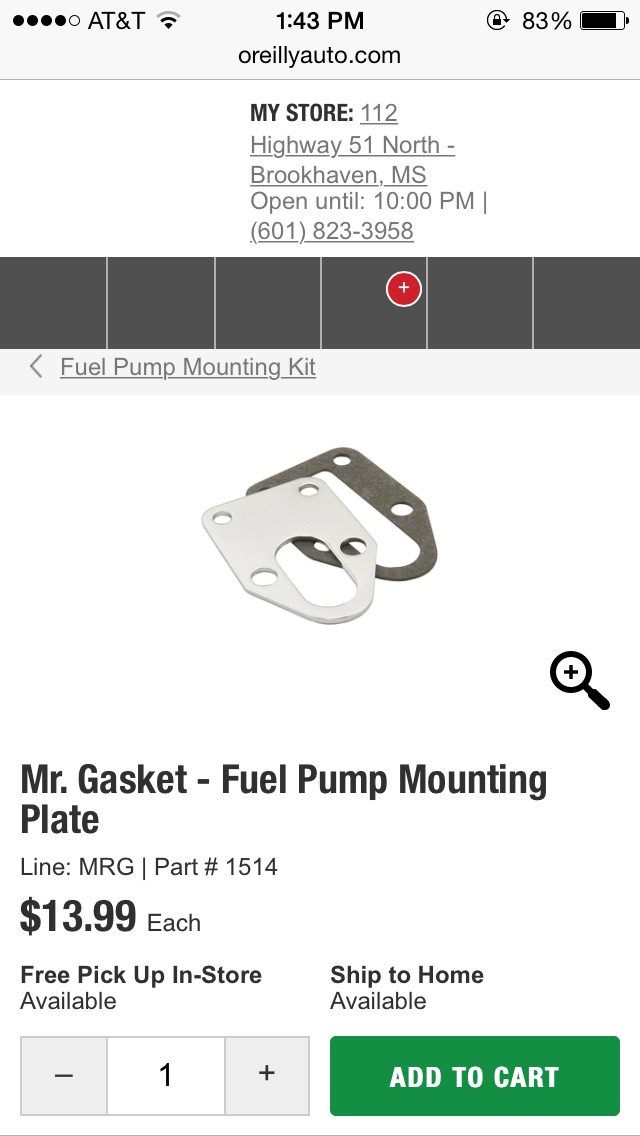

Yeah, I would definitely do George's suggestion first. I've actually never worked on a 250, but I'm assuming it's exactly the same as the others. The pump mounts to a thin metal mounting plate which bolts directly to the block. I don't think the rod will come out without the mounting plate off of there. Here's what it looks like. I doubt that'll end up being the problem, but like you said, anything's possible. And theoretically, it may not be completely wiped, just enough to halfway push the diaphragm in the pump.

Damn. I wish I knew more about the 250. Did you see the mounting plate? If you take it off, the pushrod should be clear to come out. I searched for it on O'Reilly, and they showed a pushrod for the 250. I'm not trying to conflict with anyone, but it's hard to imagine the cam lobe scrubbing on the pump arm. The pump looks just like all the other ones. Can I also see a picture of the pump off? Have you tried taking pictures in there to see if the cam lobe is for sure directly in contact with the pump arm. If the plate comes off, and no arm comes out, then the cam lobe being worn from rubbing on that arm definitely comes into play. I'm not trying to doubt anyone. I'm just extremely vexed by your predicament, and I wish I knew more about the Inline 6.
