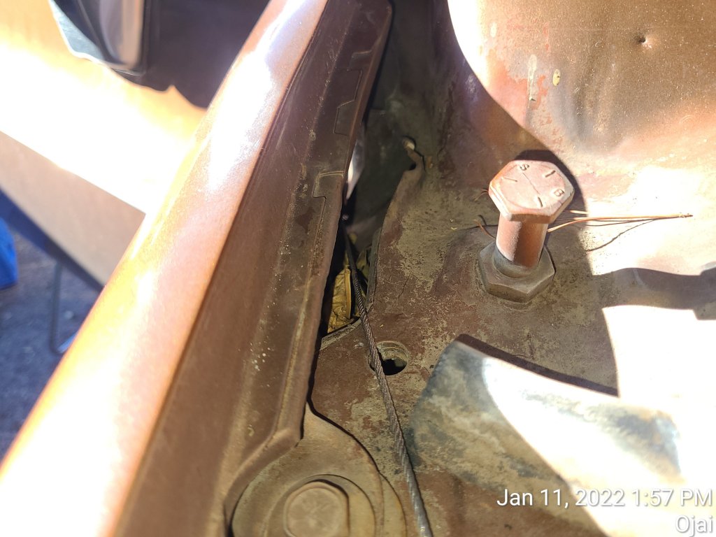

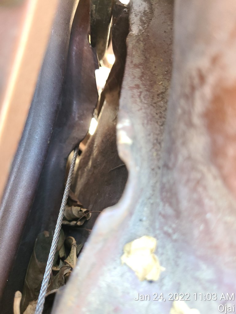

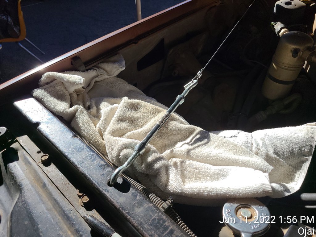

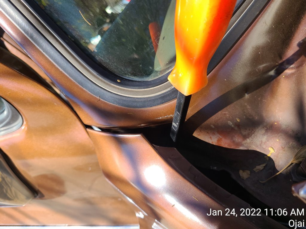

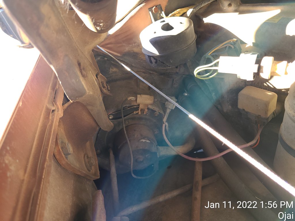

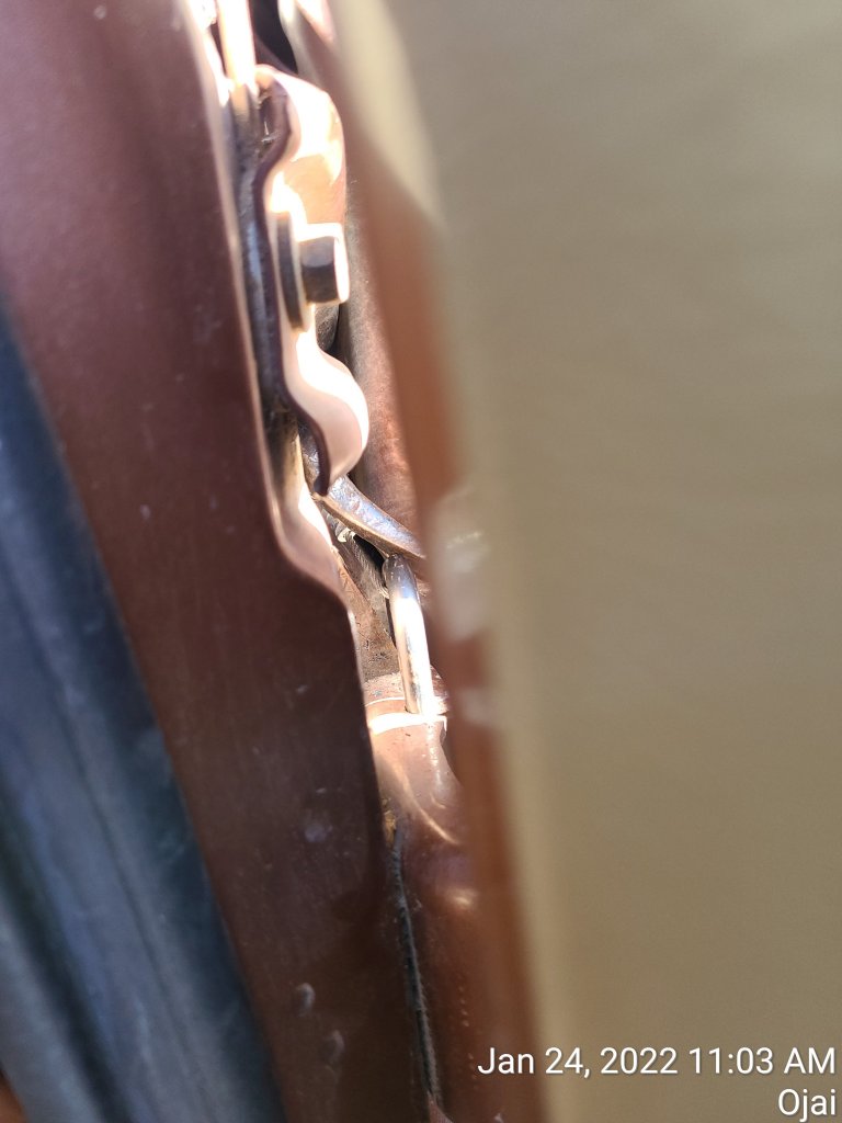

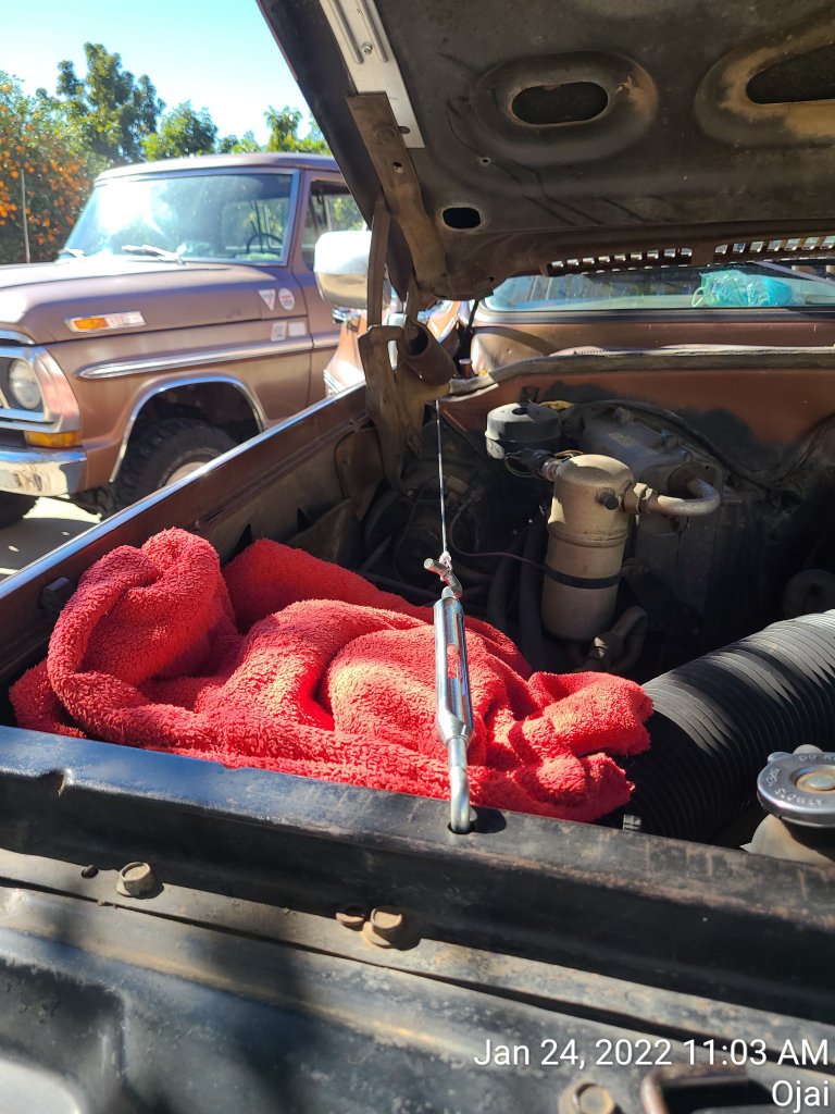

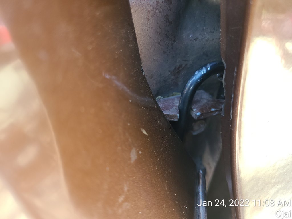

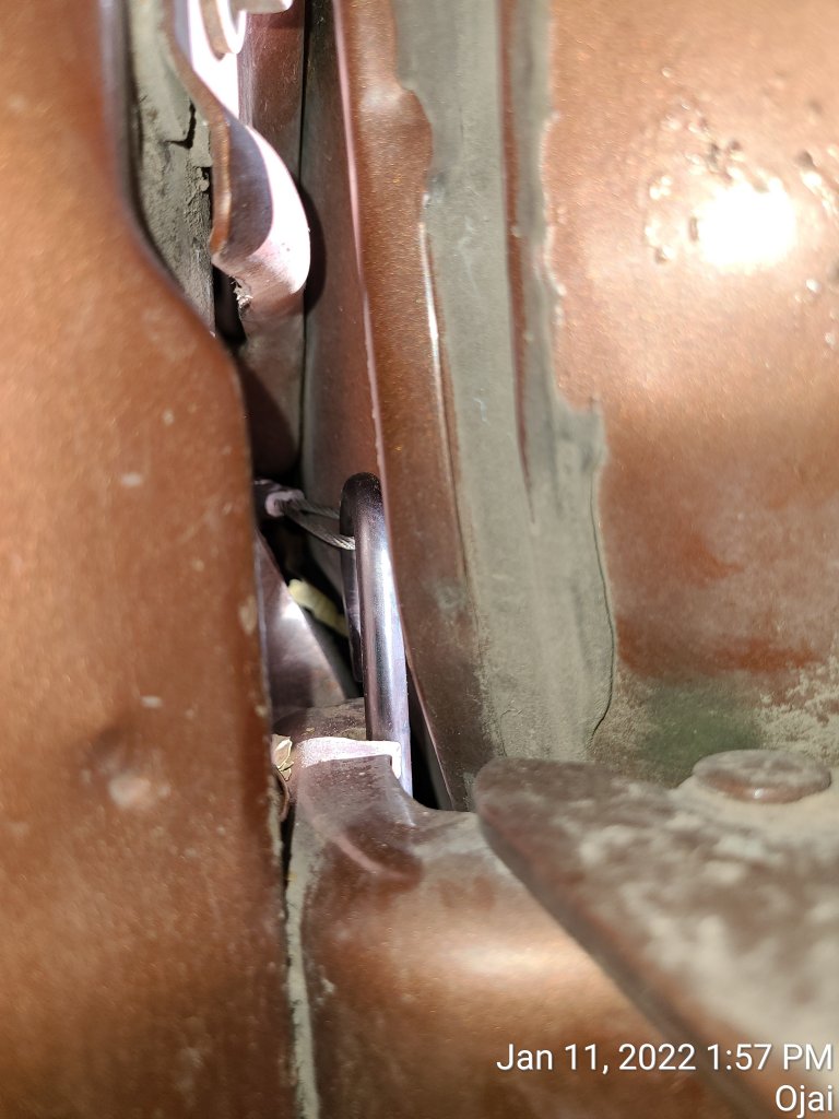

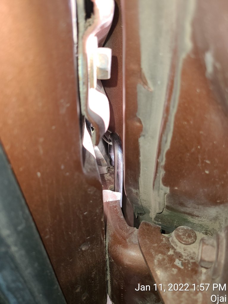

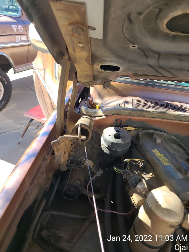

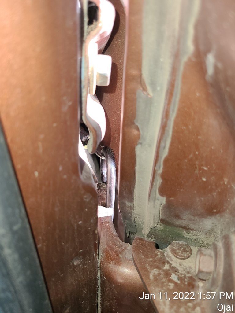

I was told that replacing the door hinge spring is impossible unless you either take half the truck apart or take the upper door hinge off. Sounds like a challenge more than anything else.
The following tips are almost guaranteed to chip paint unless you’re extremely careful. On the first side I chipped a little paint. On the other side didn’t chip anything. I had both springs in within two hours without taking anything apart.
Here’s a few good tips that worked for me. With the cable holding the spring in place good and snug, you’ll want to see how far away the top end of the spring is from sliding into place. Take the spring back out and put it in your vise and take some of the tension out, in other words bend the spring so it closer to dropping into place and not so far away.
I also ground off a little material on each end of the spring maybe about a sixteenth inch or a touch more, I also ground a little bit of an angle on the top end to help assist sliding over the door hinge.
The most important thing is to take some of the tension out of the spring and get it lined up closer to hammering it down into place. And after thinking about it maybe taking some tension out may help the life of the spring.
Once you have it as close you can use a sharp chisel and molly whopper and whack it in place from the top of the spring, it’ll drop right. Reach out if anything needs clarification.
Also I’m a Ford guy, it took a Ford guy to figure it out, just saying. Helped a friend with his no problamo.
I have more photos but the forum would only allow me to upload five photos
