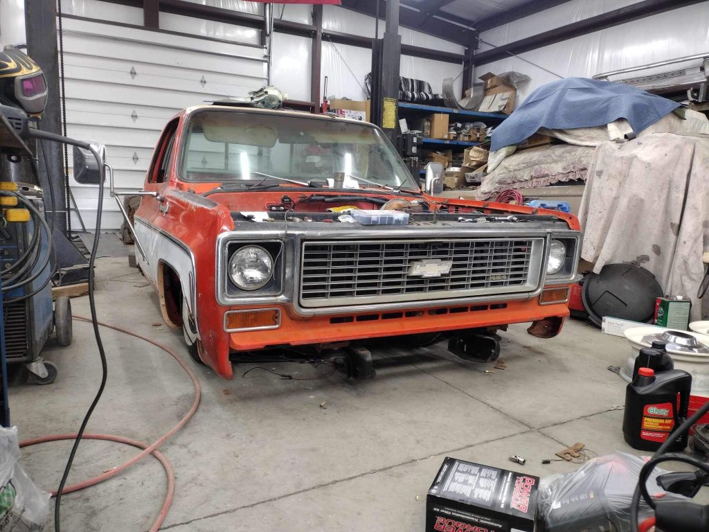

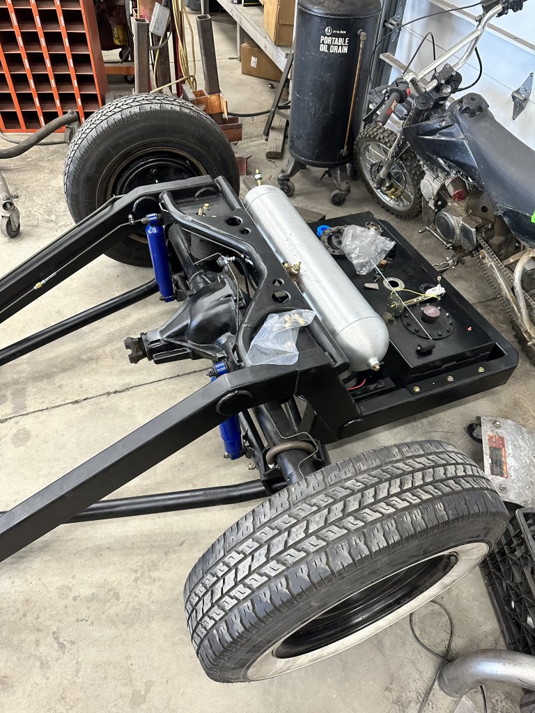

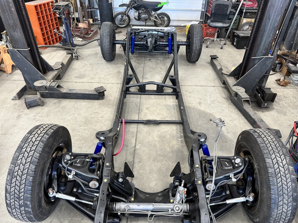

The whole idea for this truck. Went up north from me found this truck on a ranch bought it and just slam it on air ride
Left the truck entirely alone no paint, no body work, just let the Arizona sun do its thing

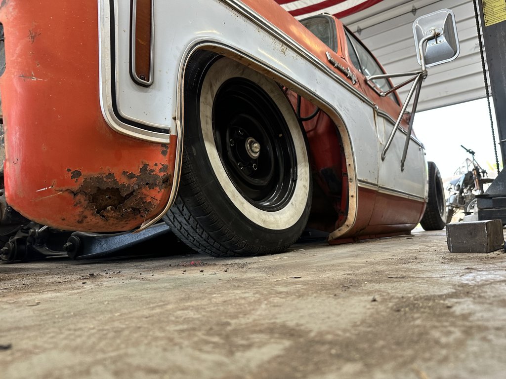

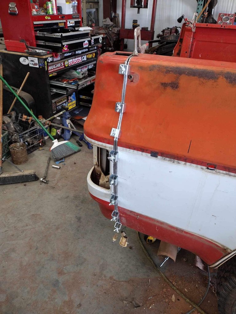

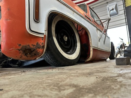

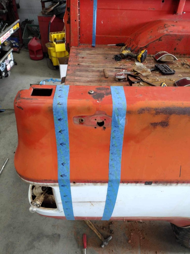

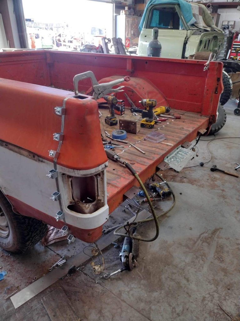

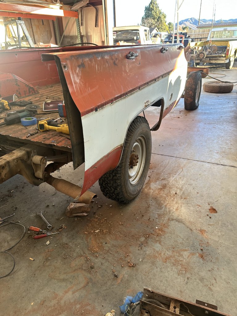

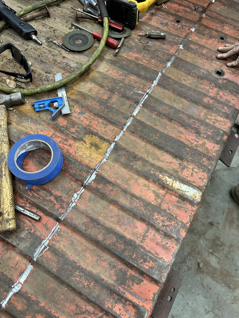

Before I get burned at the stake for this I just want to let you know this was the plan from the get go.
Extensive research and 1 YouTube video I felt confident enough to do this.
6” in the rear 14” in the front and kept the stake pocket.
